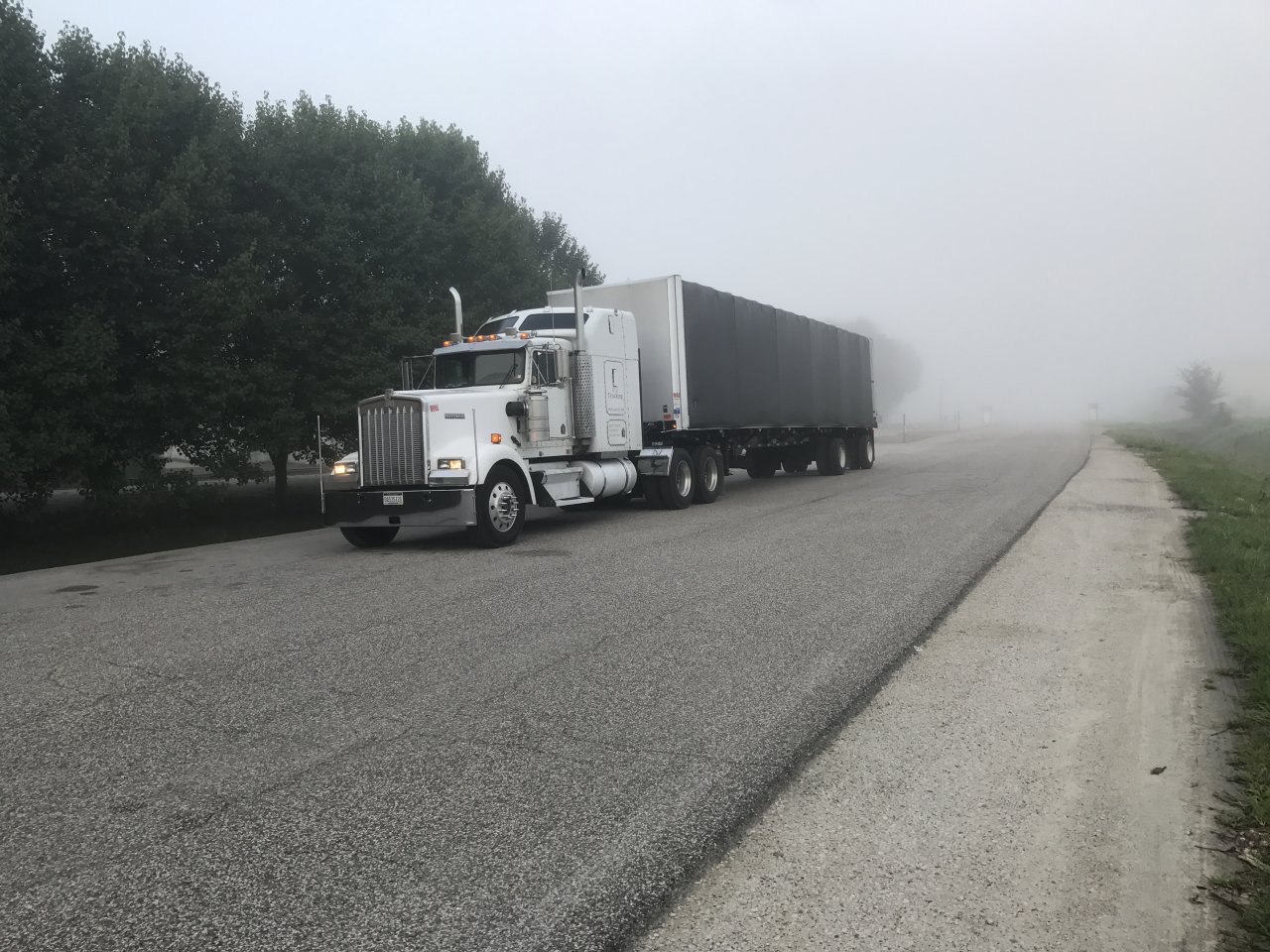

    IMG_6175.JPG Full of fuel I'm 33,900 lbs. but I have a combo trailer. It sure saves a lot of time!! 95% of my loads need tarped.
    luddybuddy, wore out, stwik and 5 others Thank this.
