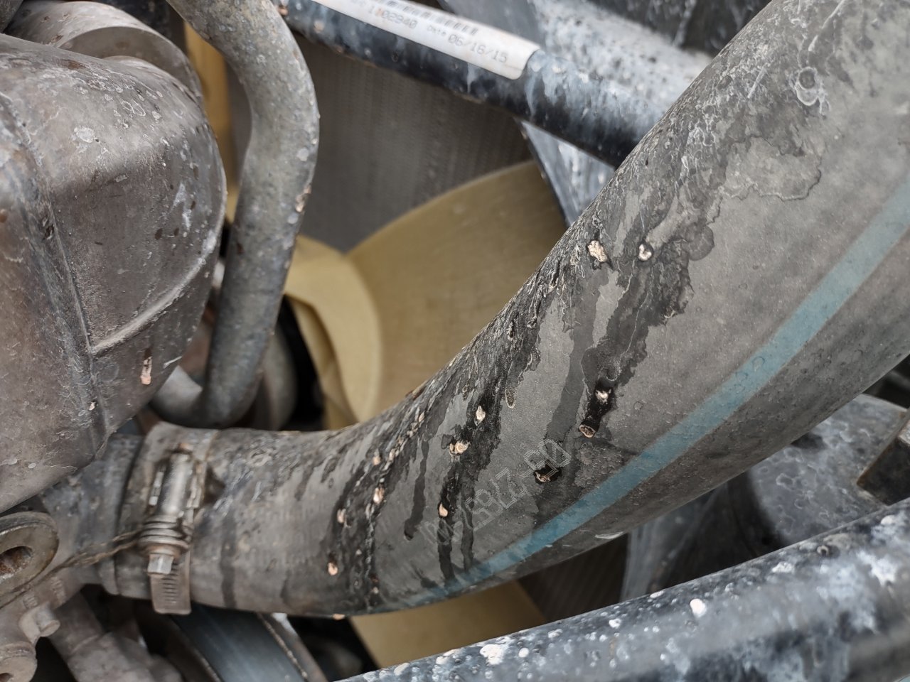

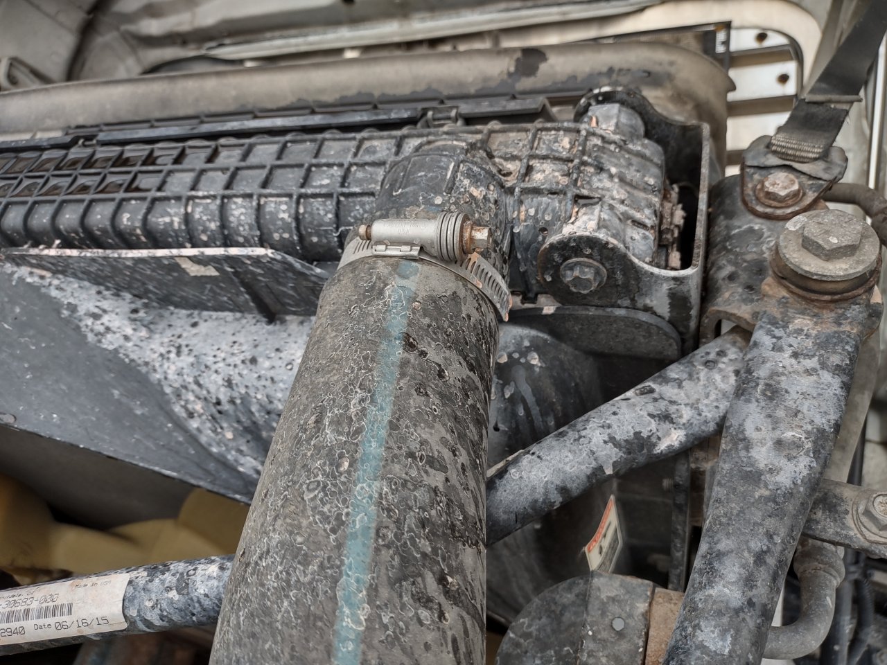

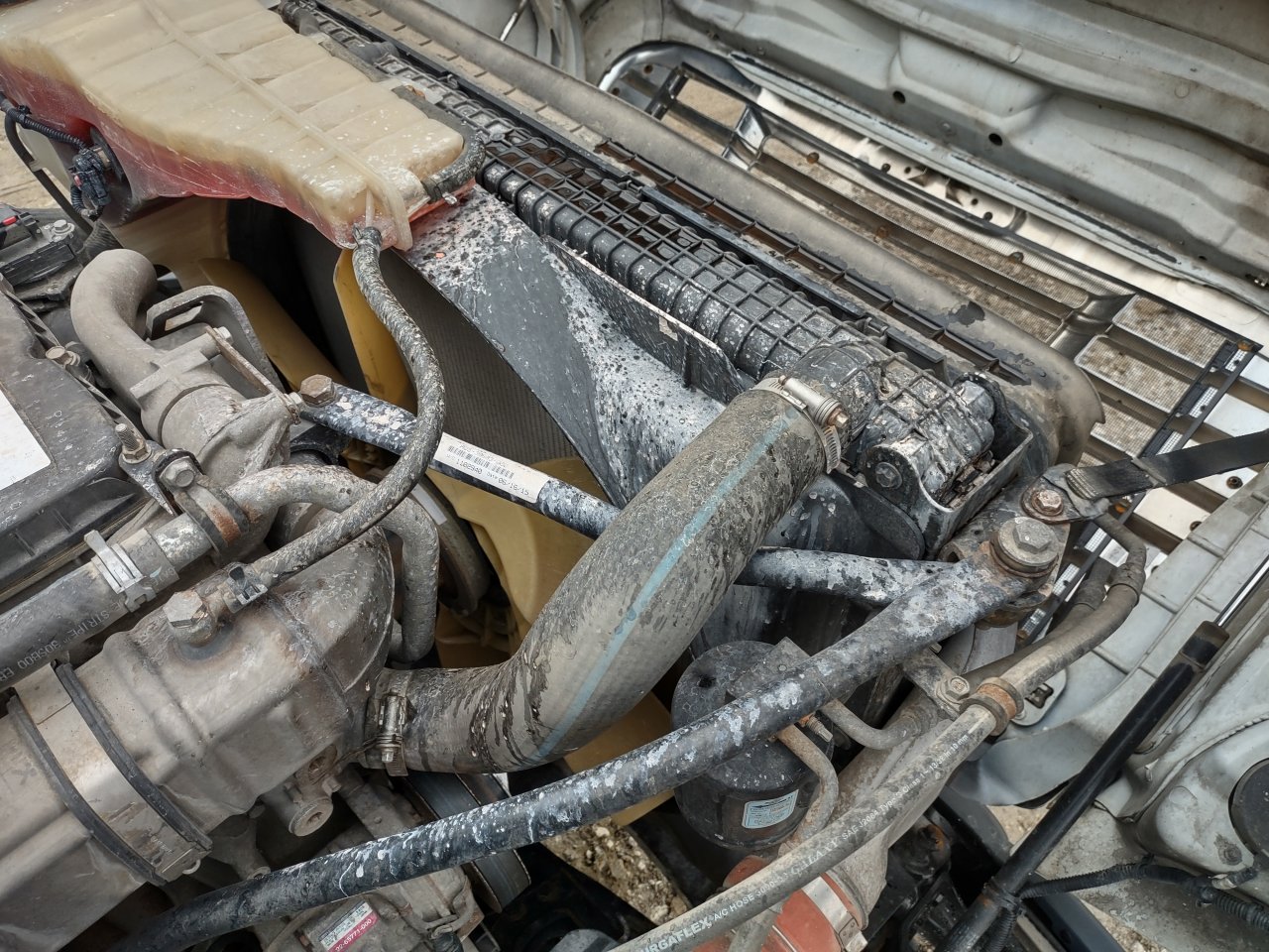

    Noticed a coolant smell coming from the engine bay area the other day. Opened the hood and low and behold the coolant level had decreased a bit. Maybe 2 inches or so but still above the minimum. Noticed there was coolant pooled on top of the radiator. Anyways I have some pictures that show more detail. I'm assuming it's coming from that main hose at the top, because the fan ends up blowing it all over the place. Probably get a pressure pump to pressurize the system. Thought I'd run it by you guys. probably where the clamps are. It's hard to pinpoint coolant leak pic 1.jpg coolant leak pic 2.jpg coolant leak pic 3.jpg coolant leak pic 1.jpg

  3. D.Tibbitt
    22,861
    158,069
    When that happened to mine it was a cracked neck on the radiator. So the plastic piece that is connected to the upper main hose is where it was cracked. I ran mine for awhile until i could get to a shop.

  4. Rideandrepair
    17,584
    56,954
    Aug 8, 2015
    That’s probably it. Might get lucky and it’s the tank, or hoses. I see some up there, on top of the shroud. Hard to say, fan blows it everywhere.

  6. Rideandrepair
    17,584
    56,954
    Aug 8, 2015
    I wonder if it could be plastic welded. They have a kit at Harbor freight. Use zip ties as welding rods. I’ve seen thus on UTube for automotive repairs. Wonder if it would work on the neck? Or some JB Weld epoxy.

  7. joseph1853
    joseph1853 Road Train Member
    1,003
    562
    Dec 12, 2010
    Waco, TX
    Probably. I'm going to get a pressure tester to verify where the leak is and probably try something along the lines of what you're talking about.

  9. bad-luck
    bad-luck Road Train Member
    3,463
    6,389
    Nov 16, 2013
    Baltimore, Maryland
    Most likely a cracked reservoir, cracked radiator or a bad hose. Top it off rev the engine up to say 1400 rpm. As the temperature of the engine rises you will find the culprit...

  10. Rideandrepair
    17,584
    56,954
    Aug 8, 2015
    O Reilly’s and Autozone will loan you a pressure tester.

  11. joseph1853
    1,003
    562
    Dec 12, 2010
    Waco, TX
    Yeah, that's my next stop. Rent one of their pressure testers. Hopefully, it will have an adapter that fits.
