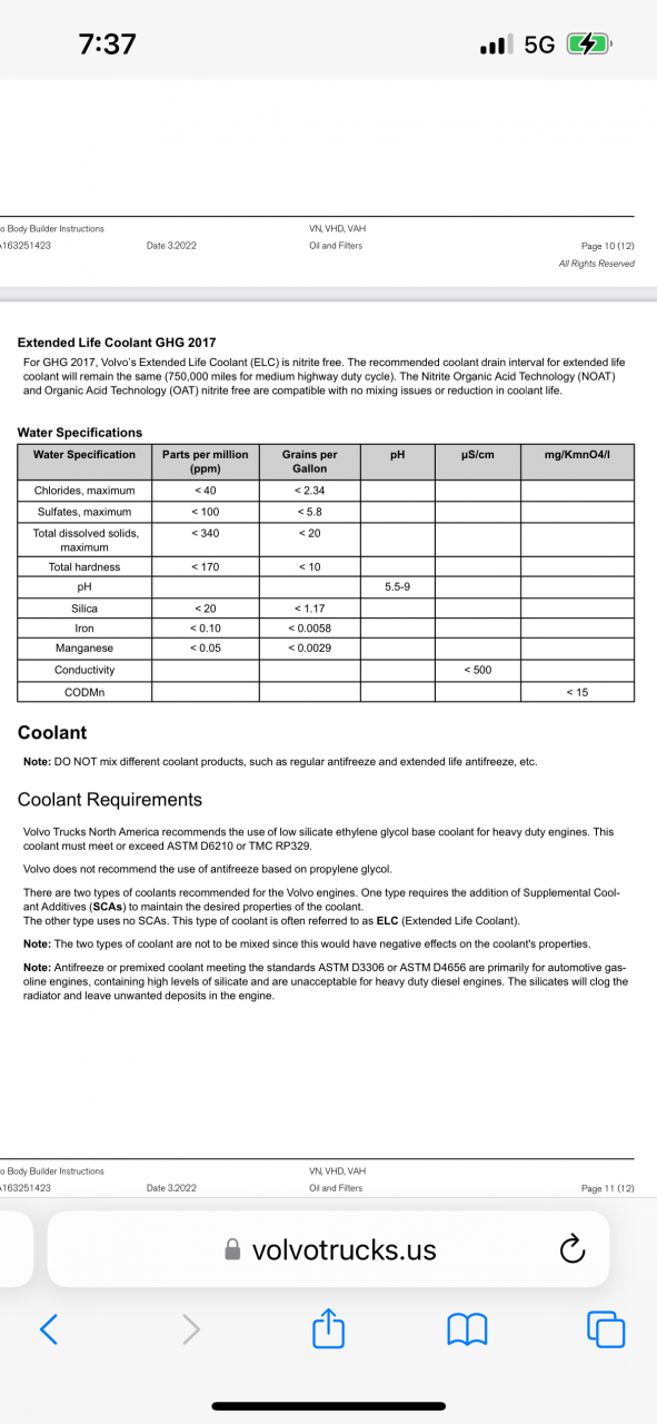

    I bought a used 2022 Volvo, D13 engine, 270k miles... don't know the service history on it, but pulled a sample into a glass jar and it appears to be an orange color, maybe even a pink hue at different lighting. Talking with RDO Volvo said use a Delo ELC coolant that is pink for newer Volvo trucks. A smaller reputable truck shop said any of the pink/red/orange heavy duty ELC coolants should be fine. There's no sticker present on the reservoir and the manual doesn't state either.

    2) What specific OAT coolant does Volvo call for the D13s? Nitrite and phosphate free?

    Your dealer is correct; pink ELC. The cap of the jug indicates color of the coolant. I’d buy a paint marker and write on the jug “Volvo Only”, for your employees.
    My PACCAR runs the orange ELC.

    Look at the labels on the jug. Should give you an ASTM or an MAT spec.

    Most of them will have the engine builder spec on them as well.
