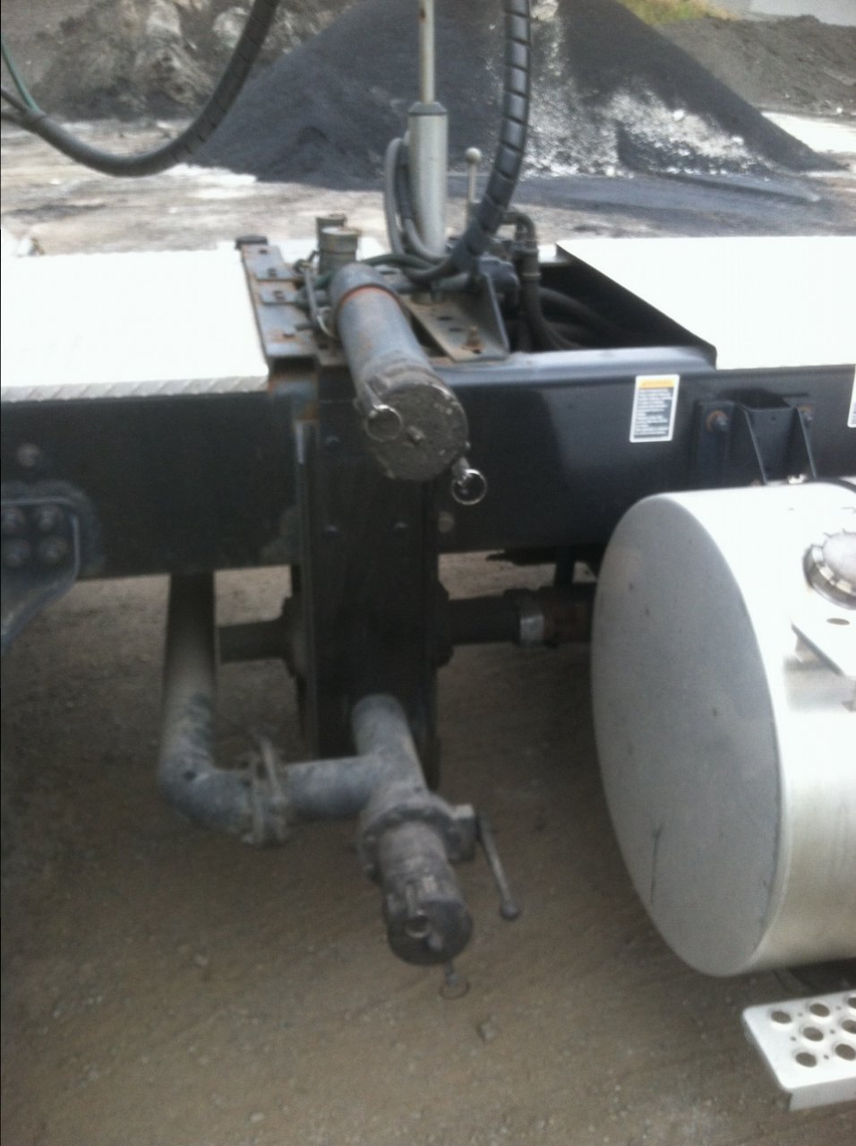

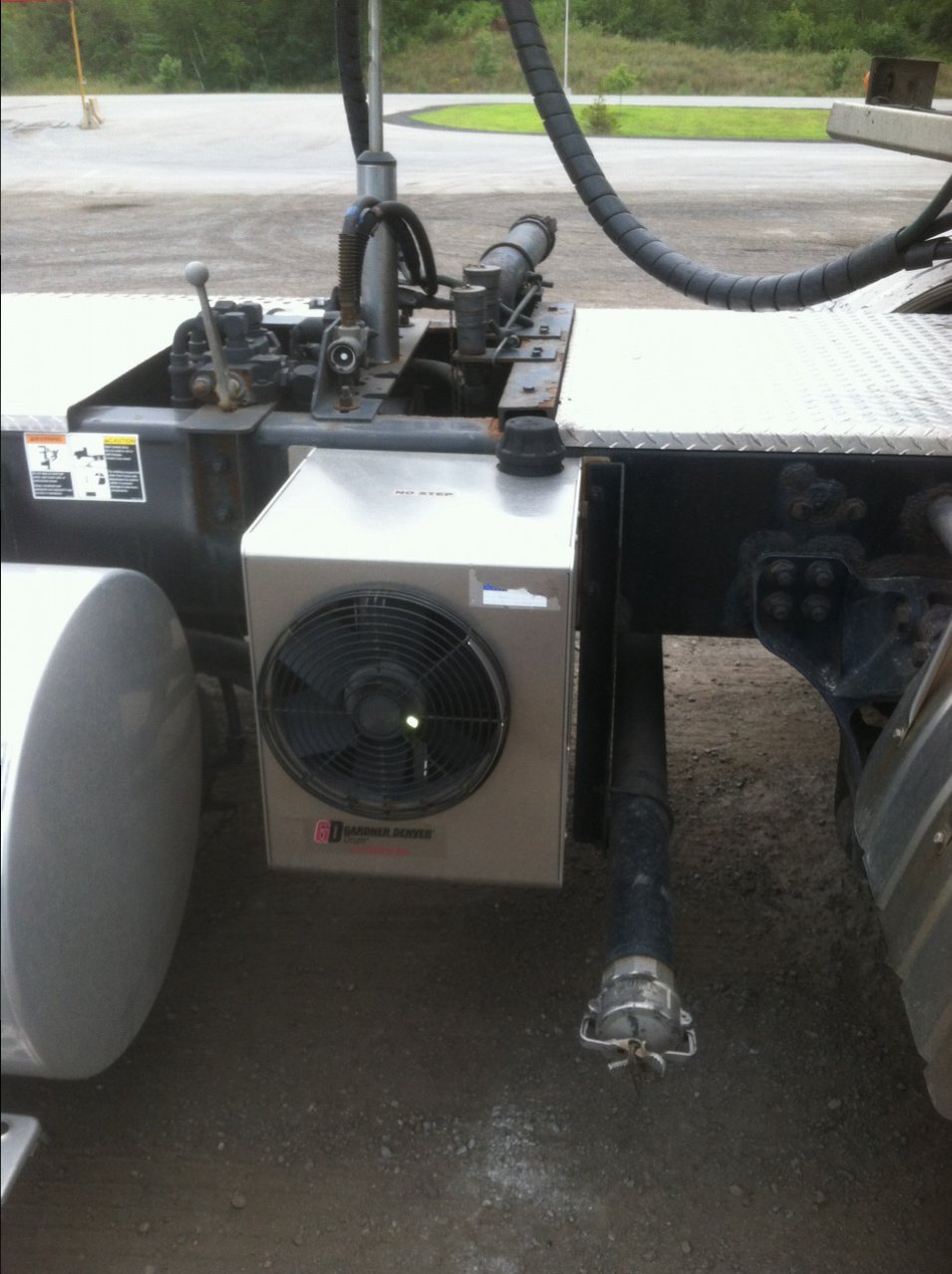

    image.jpg 10k and up depending .....you doing hydraulic ?
