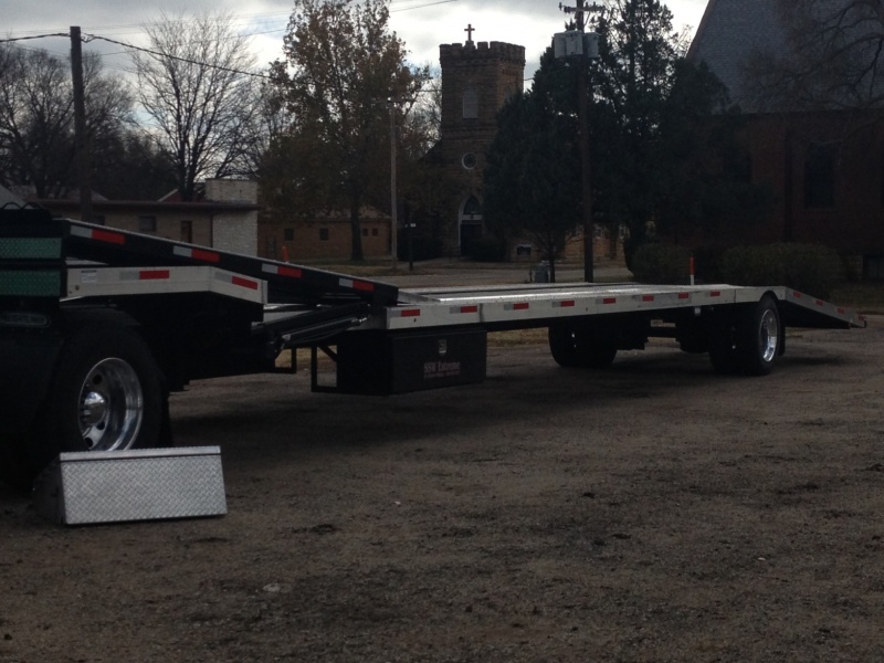

    Ok, here are the pics as promised. As you can see in the pic, yes the shoe is cracked and yes, I did have it replaced, and I had Freightliner do it just so I had a paper trail.
    When I questioned the mechanic about this shoe (all the rest checked out) he rolled his eyes and said something to the effect of %^&&* over efficient ^&*(&& jerk !!!!
    He said in his opinion ( and he made sure that I knew he has been a truck mechanic for 18 years) that this was a non-issue and that he would bet it would have never created a problem.
    Also I included pics of the trucks and trailer, you can see they are not crap equipment. I guess draw from it what you will,
    Thanks
    Stan
