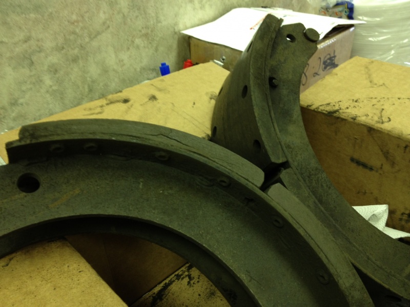

    But from where the crack is located could extend inward thru the shoe material to the rivet area, which is part of the rule. I had to pull off a set of steer shoes for a similar but smaller crack.

    I changed mine out for the same reason on the steer axle that were well over 50% left on them & only gross 64,000 lbs max.
    What I failed to do was ask if there are different grades of brakes pads & probably should have upgraded at that time.

    I'm sure it really makes no difference, but what he actually wrote the truck up for was 393.47a which states that, "the unit has inadequate brakes for stopping" I was not written up for a defective part.
    I guess to me this means the insp. made an assumption that my rig could not stop within a specified distance, considering what we weigh, and the fact that trailer has air disc brakes on it, I would put my stopping distance up against any other rig that he pulled in that day.

    Violations found during a North American Standard Inspection are documented according to criteria developed by the FMCSA in conjunction with the Commercial Vehicle Safety Alliance (CVSA). (ref 350.105)
    The regulations make general sweeping rules about all lugs being tight, all brakes being in adjustment, all lamps operable, etc. It is the CVSA out of service criteria which delineates how bad a violation must be before a vehicle is placed out of service for it.
    393.47 makes statements about how brake component physical characteristics must provide for safe and reliable stopping of the commercial motor vehicle. It is the CVSA criteria which spells out how bad a crack in brake linings must be before placing a vehicle out of service.

    They talk about every other aspect of a brake lining. What's a few more words? The CVSA is pretty clear and concise. It wouldn't hurt anything to carry that data over so drivers could easily find it. That or start selling NASI or CVSA bibles drivers could carry around.

    i must be blind or something. cuz that don't look like a crack to me. it simply looks like the brakes were molded that way. i bet another pair of shoes from the same manufacture would probably look the same way.
    just stating the way uit looks to me. so don't shoot me please.
