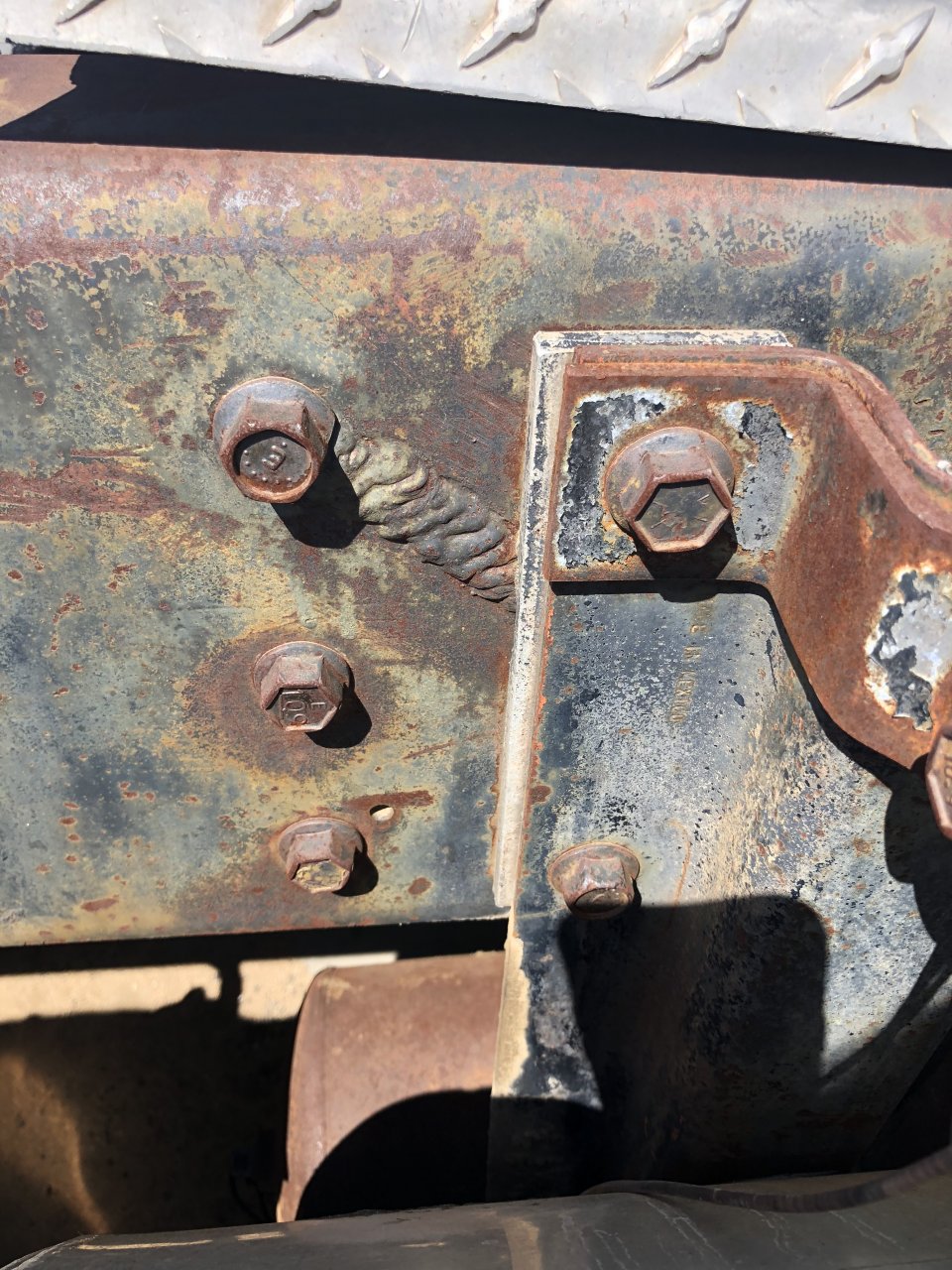

    Yes. They did weld it before plating it. Motor mount was right next to the crack, so didn't have much room inside.
  3. Diesel Dave
    9,801
    33,938
    Jan 20, 2010
    Hesperia, Ca.
    How long is the sleeve they put on ?
  4. jotz007
    jotz007 Bobtail Member
    25
    7
    Jul 31, 2011
    Toronto, Ontario
    About a foot long, 6inches each side of the crack..
  5. Diesel Dave
    9,801
    33,938
    Jan 20, 2010
    Hesperia, Ca.
    Well...... long as your satisfied with the work but my crack on my frame wasn’t as bad as yours and they added a 6 foot inner frame rail inside. Just keep an eye on it. I have the truck parked, I will take pictures tomorrow and post.

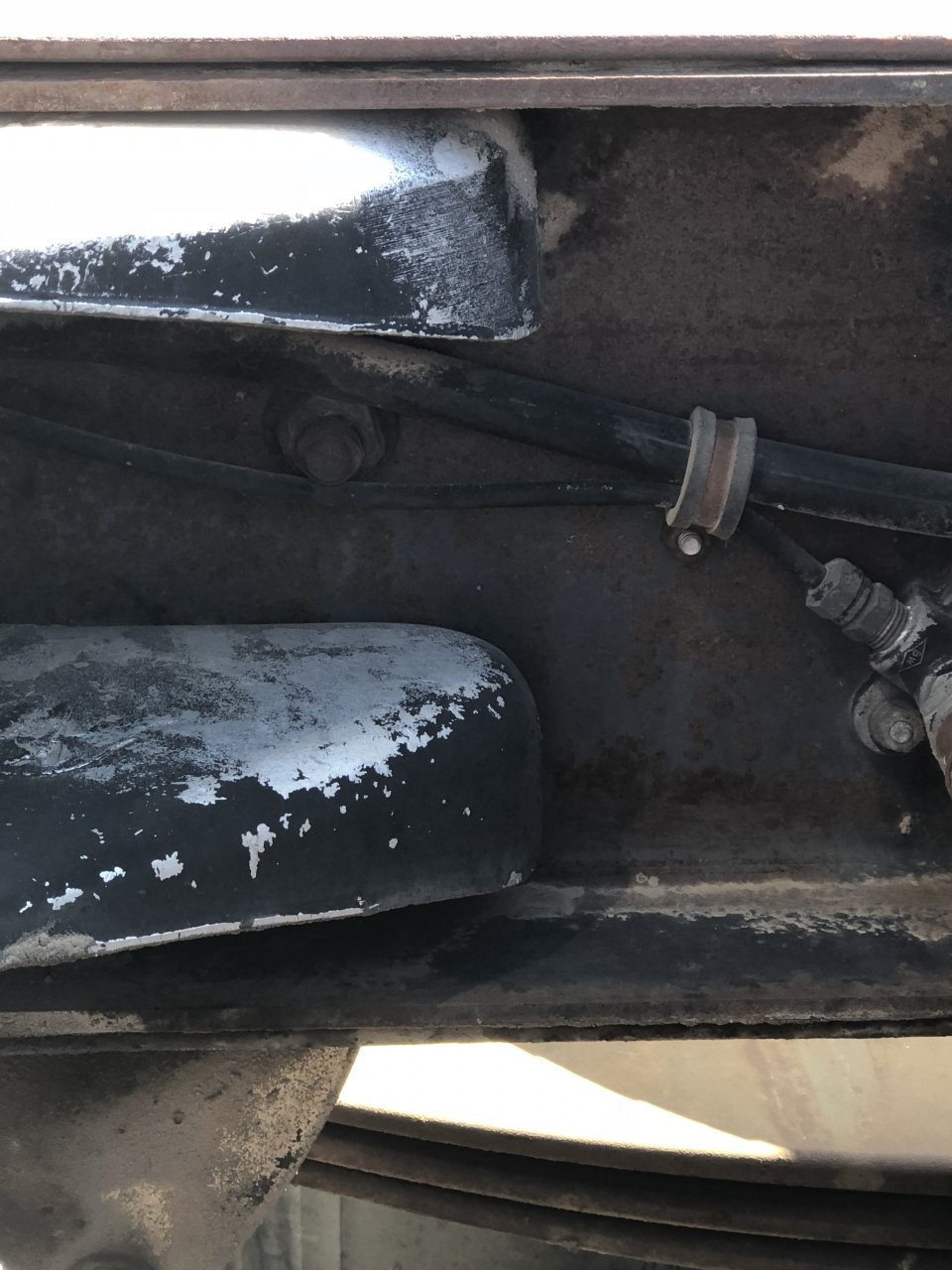

  7. Diesel Dave
    9,801
    33,938
    Jan 20, 2010
    Hesperia, Ca.
    642FC93C-E26D-4D14-A1B9-CD3DBE909B39.jpeg EDA56714-7C53-4A01-A8E9-A58B8FF604B7.jpeg B00576A1-BD5A-46B8-856A-557F248FE0AC.jpeg A4257421-5F40-4D3A-9C75-B5E2A81E183A.jpeg As I was taking pictures, just realize the inner frame channel that sleeved it is 8 feet long. It goes beyond the motor mount and way back beyond the center hanger of the rear suspension.
    Vampire, Ruthless and Expeditor Thank this.
  8. Diesel Dave
    9,801
    33,938
    Jan 20, 2010
    Hesperia, Ca.
    When I bought this truck in 84(my second truck) I noticed small inner channel plate in the inside of the frame. Well I didn’t realize it was there cause it had a cracked already. It was sort of hidden. Anyways..... 6 months later I noticed th cracked and had realize why the plate was there. As you can see on the above pictures, I had it repaired correctly when I had it done.
    To the OP...... that small piece they repaired your cracked frame, reminds me of my original one. Beware....... it’s not going to last if you haul heavy. Btw, my K100 has been parked for 11 years. I still have it. Can’t seem to part from it. But it’s all intact.
  9. jotz007
    25
    7
    Jul 31, 2011
    Toronto, Ontario
    Thanks! I am taking the truck back to the shop who did it. Try to get inner plate inserted.
