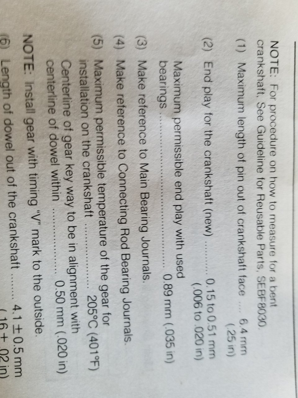

    1997 3406E std bearings and thrust washers.
    had crank polished, they say it stayed at std size.
    installed new bearings and thrust washers.
    measured end play its at .0117, what is the specs for this supposed to be??
    thanks for helping

    I dont have the correct manual! I have one for a c15 accert!
    Is anything interchangeable between the 2 Manual wise?
    If not I will go buy one?

    I would want the right one, lots of similarities but some differences too. Especially with rod bolts and torque

    Turns out my end play is .0117!
    My new dial indicator reads out to 4 numbers instead of 3!
    Feel stupid! But I know it's good though!
