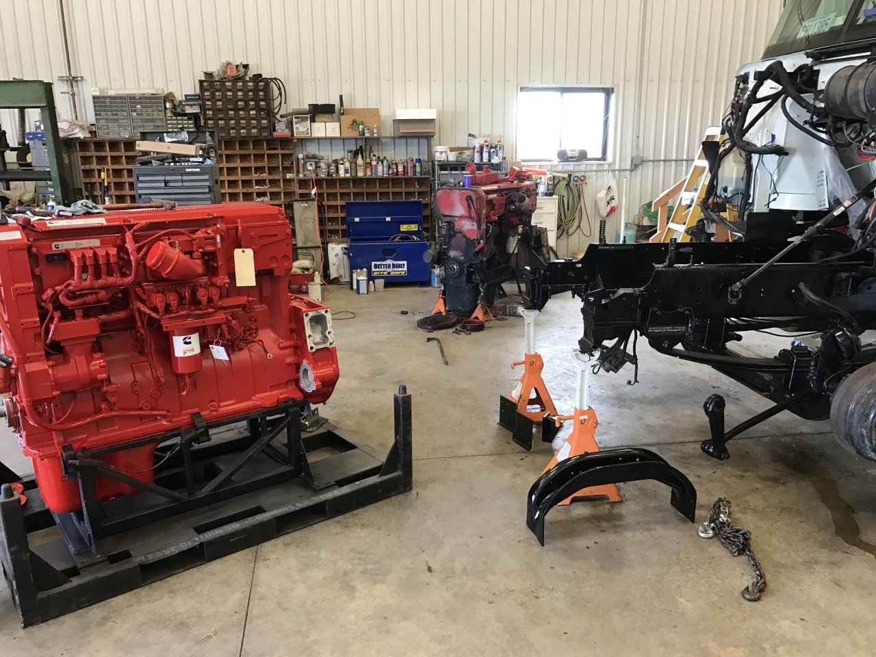

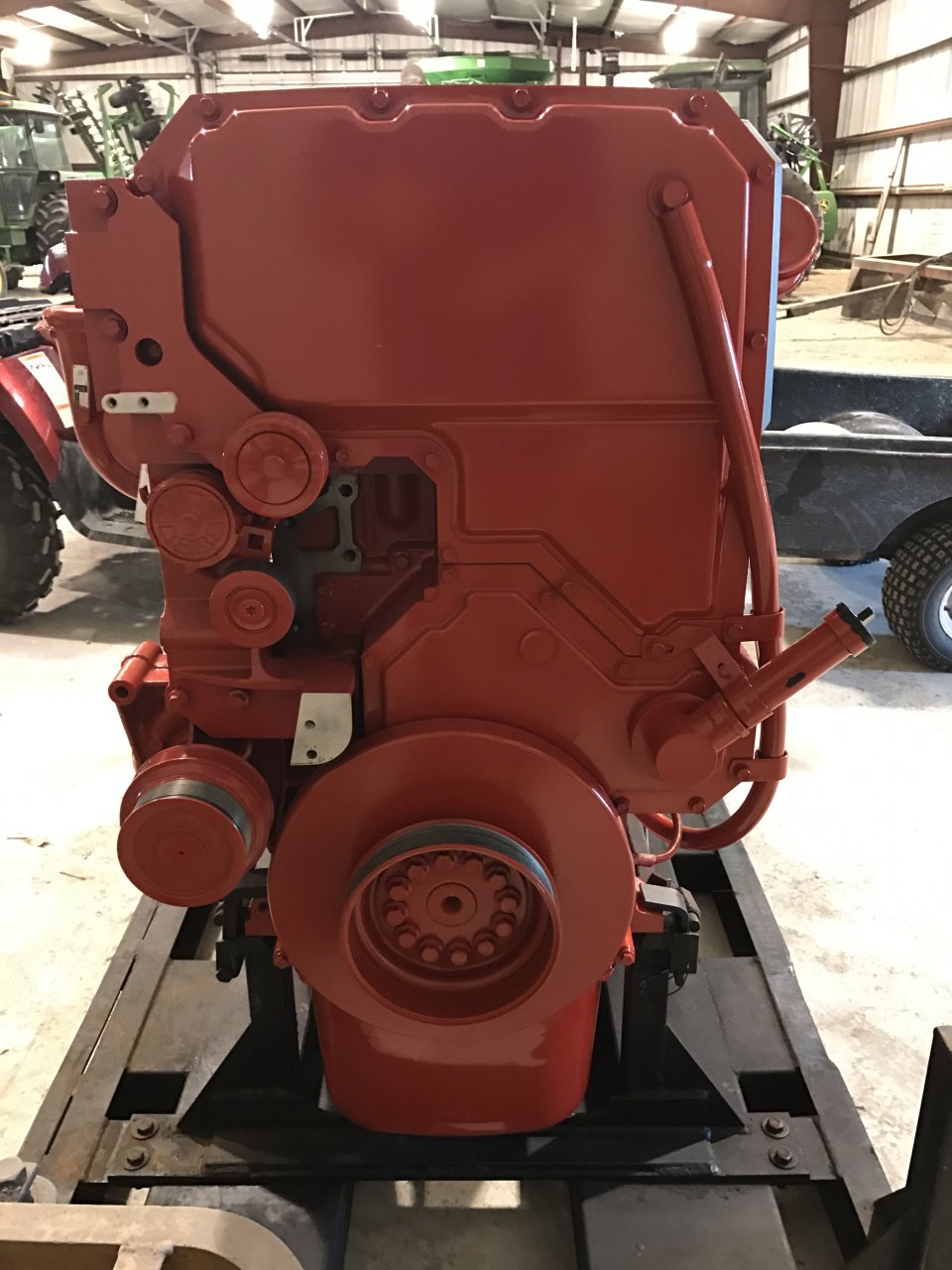

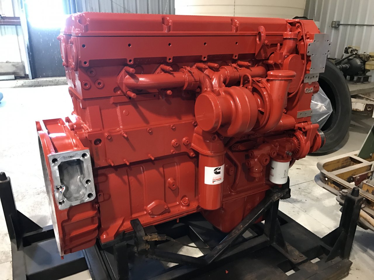

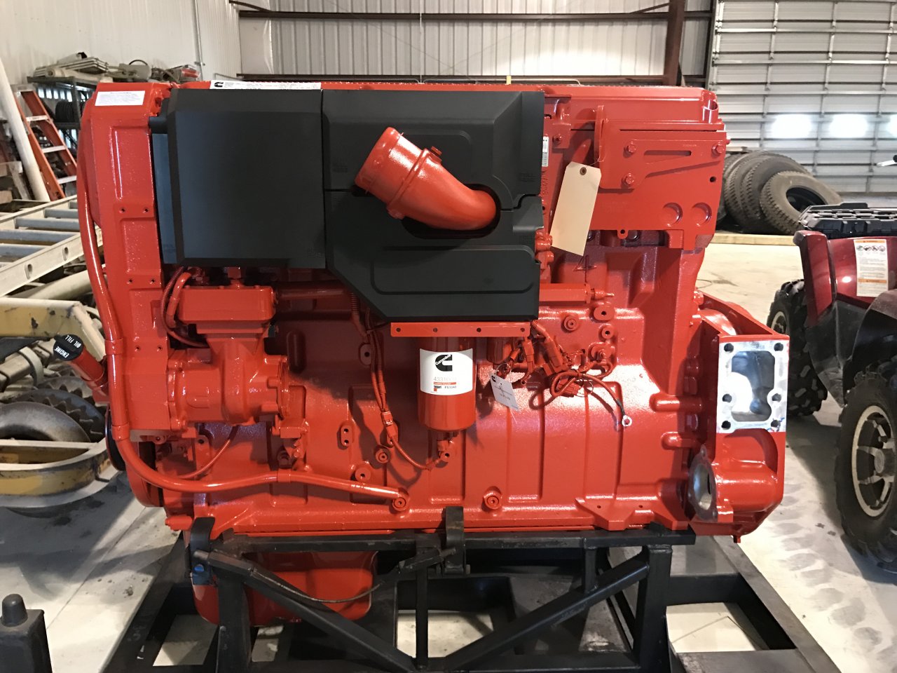

    Mine was a 2002 and older. (870 maybe?)
    Once I made the decision it was about 10 days till delivery at our shop.
    Putting the engine in was easier than any car or pickup truck I’ve done in the past. Other than the weight it was a piece of cake. F2BCD747-CC76-456A-9AF2-A6EFD71C2514.jpeg BC0BB674-4AB0-4DDA-A18C-6C035322E35A.jpeg FEE2323F-3EB8-404D-9169-113D373BC946.jpeg BEC07CC5-3A6E-4173-8007-2BC270CFFAE2.jpeg
