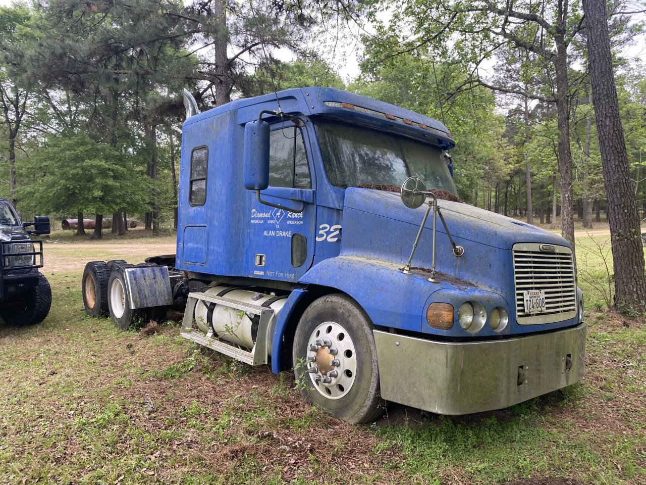

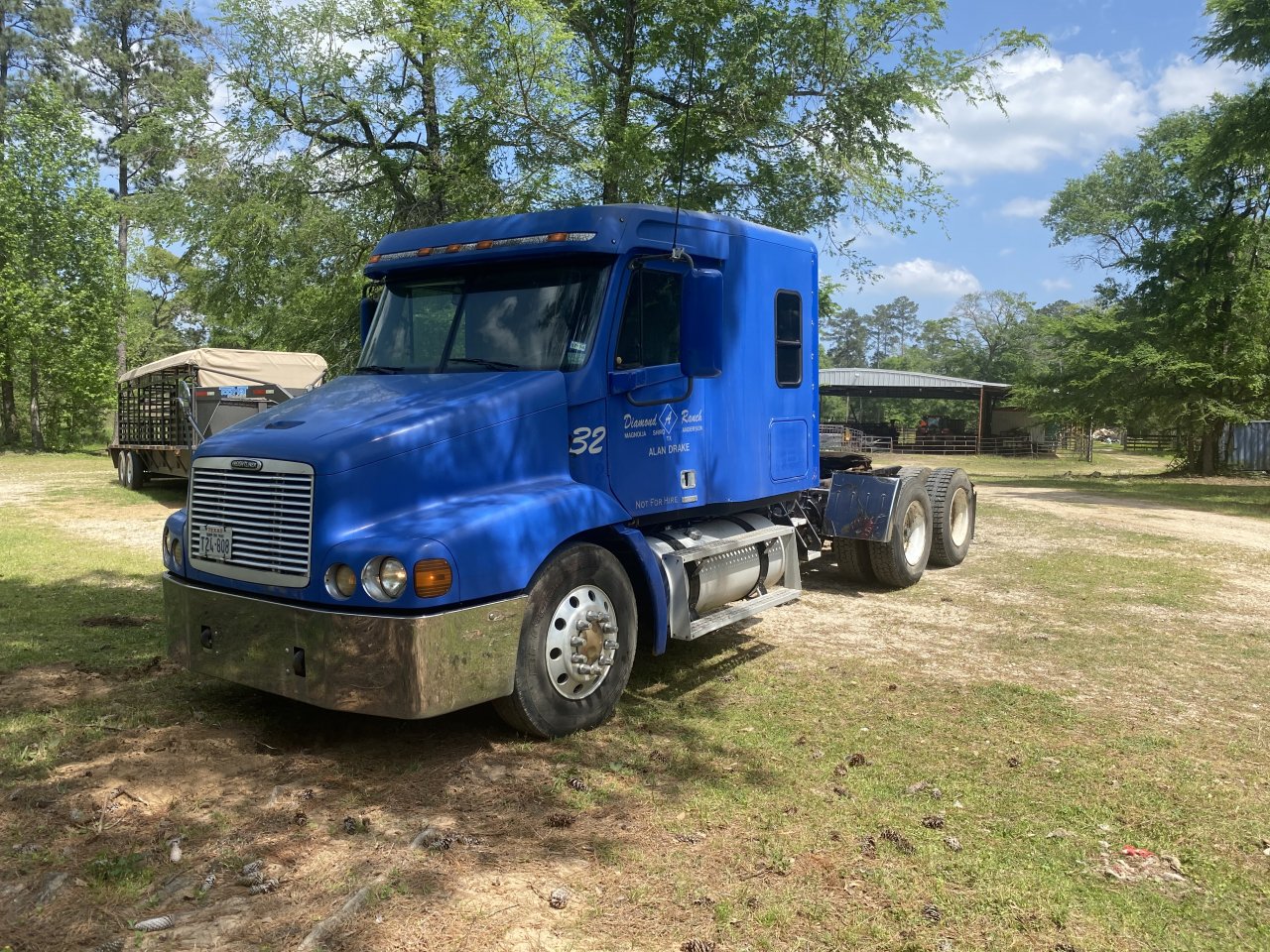

    I was talking to a buddy I’ve known for years and he said I should buy his dads old freightliner. I had seen the truck years ago and discounted it but kept thinking about it. He told me the batteries are dead and I think the transmission needs a solenoid. It had been sitting for two years and not used for around 6. This had be concerned but was still interested. We set a time and I drove over to see it telling myself if we could get it to start and build air I would get it. Well neither thing happened and I decided this was to big of a project this close to leaving for our big 7k mile trip in July.
    As you’d imagine I couldn’t stop thinking about this filthy 1999 freightliner Century with a C12 and gen 1 eaton autoshift. I decided to buy some batteries and see if it would start. This would prove to be a slippery slope. Here it is the first time I saw it.
    brett
  3. rustyshakelford
    rustyshakelford Bobtail Member
    43
    34
    Dec 28, 2017
    After spending a bunch at interstate battery I installed them and after ensuring all fluids were good I tried the key. Nothing, zip, nada. You could hear a click in the fuse panel but no draw on the batteries. The front drivers side was sunk down which made it near impossible for me to crawl under and get to the starter. I grabbed a compressor to allow me to release the brakes and drug it to hard ground where I could get under it. Checked everything I could find and decided to jump the starter solenoid. It fired up within about 2-3 seconds. I couldn’t believe it. It started building air and at this point I knew I had to have it and work thru all the issues. The dash would show an ecu code so no idea of the miles at the time. At this point I called a buddy with a datalink and connection at freightliner. Got the trans solenoid ordered along with everything for a full service.
    Buddy came out and could see thru all the grit and grime and confirmed this was a solid truck. His laptop wouldn’t show hours or miles though and we were thinking the battery for the ecm might’ve died and lost the data. Ended up coming back on I think. Installed the new trans solenoid and I had all 10 gears vs the low side 5.

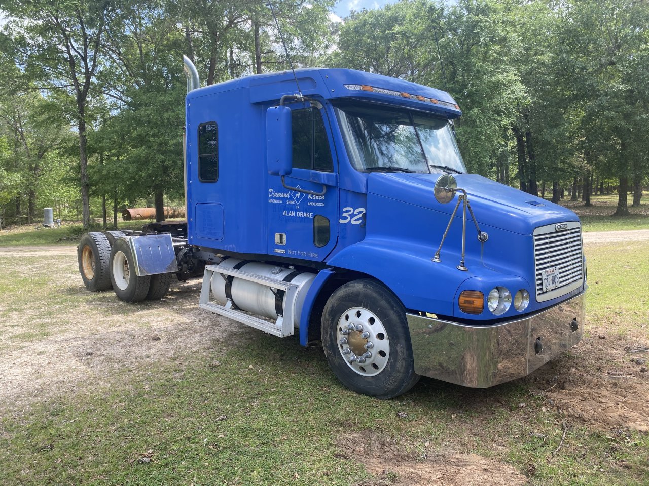

    At this point I had about 10 hours messing with this and knew it needed a bath. Got the pressure washer going and it made a huge difference. We’re getting close to attempt the 35 min drive home. Needed to air up the tires, it wasn’t running hot and everything looked great. This trip would need to wait until we have a full day.

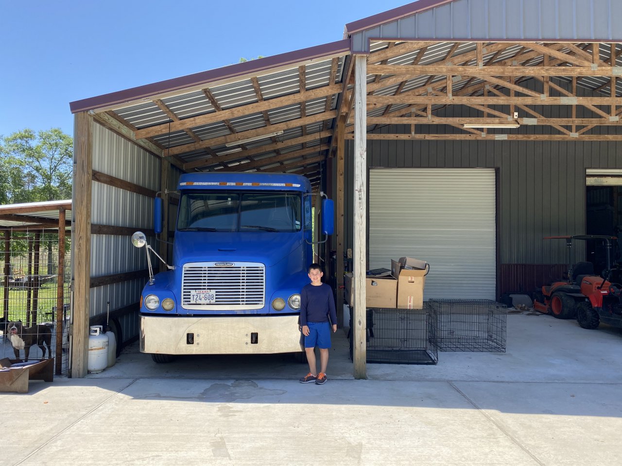

    All cleaned up

    Thats sharp looking for sitting so long, starting to feel you stole an excellent work truck to pull toys with :p

    A few days later, I asked my wife to drop me off so I could drive home. My wife hasn’t exactly been on board with this plan but I think she’s coming around. We jump the solenoid on the firewall and she fires right up. Our son asks to ride with me with I readily agree too. Give it one more pretrip and figure we’re good for the drive home. We load up and hit the road, trip is surprisingly uneventful. Jake brake sounds great, brakes are excellent and everything feels good besides the lack of A/C.
    Now it’s home, I’ve been tracking down several air leaks, pulled the bed and cabinets from the sleeper and wiping down all soft surfaces. It needed a deep clean which is what I’ve been working on. Painted the muffler with high temp paint, and getting a build plan.
    I have spend several grand at freightliner at this point. Just got home from picking up 2 prestige seats for my bride and myself. Will meet up with another buddy and install some super singles and new steer tires.

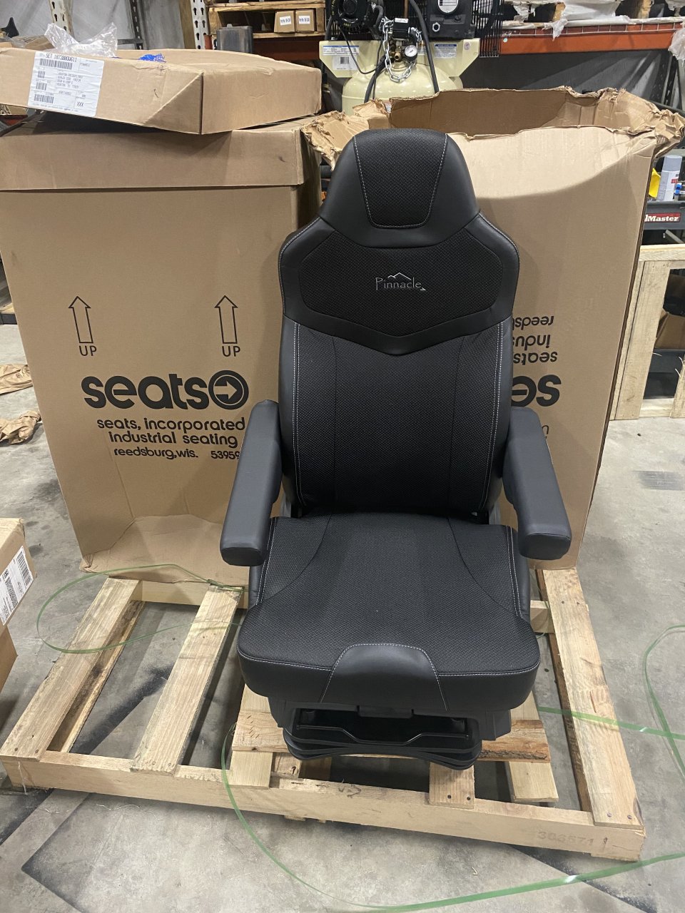

    Unboxed one of the new seats! I’m excited to get this in. They are extremely proud of them however. Was wanting the black on black leather substitute but we’re completely out so went with the mesh. Should stay cooler and not stick to us as bad!
    We’re pulling the old seats out and detailing the inside of the cab today. On the fence on how much I want to get into pulling up the flooring or just clean it as best as I can for now.
