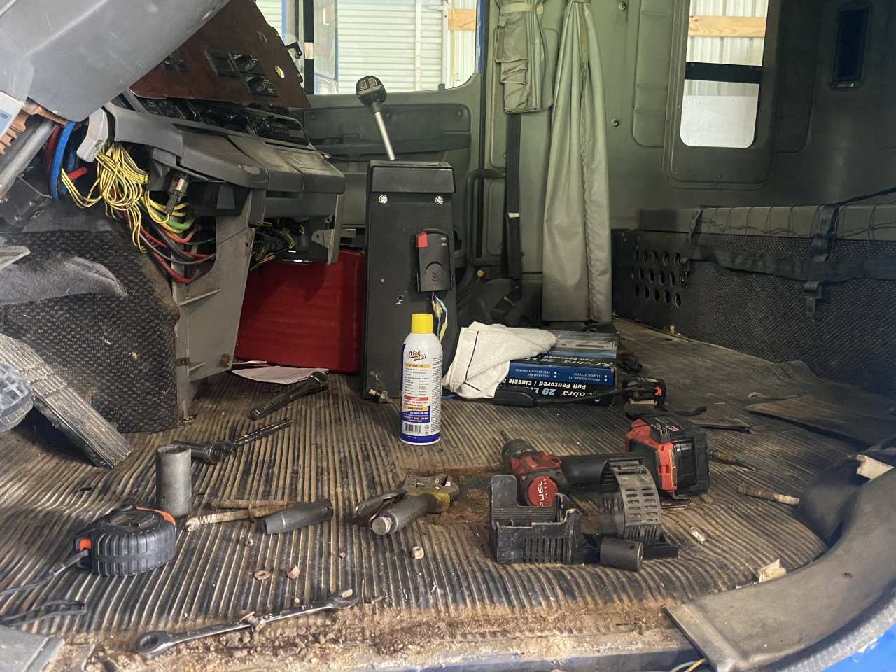

    Got the old seats pulled out today. 7 of 8 came out, one broke off. That’s going to be interesting to get out. I’m hoping I can use a cut off wheel and cut the nut off. Wont be bed to get someone to hold a wrench while I tighten the new ones down.
    As expected it was filthy. I think the truck was mainly used in the ag industry and has the dirt/manure/muck to tell the tale. Going to pull the floor liner out and give everything a good scrub.
    Our induction heater was incredibly useful for all the rust on the bolts. Rust isn’t something I’m super familiar with being in the Houston area but we’re making progress!

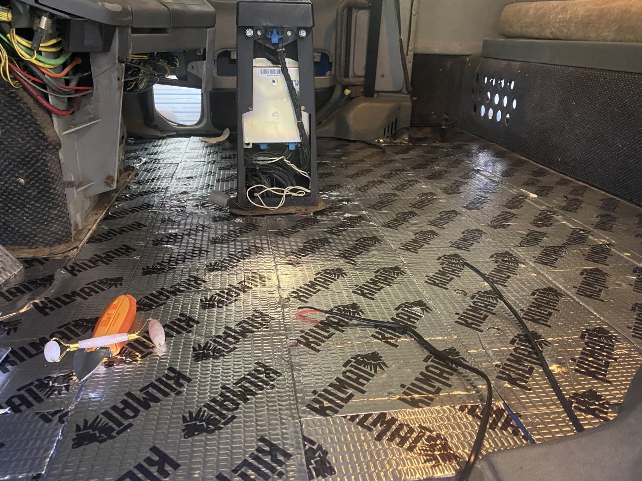

    Great reminder. Of all the things I’ve found in there rat/mouse droppings haven’t been it yet luckily. Removing the flooring was nasty. Got it all out and hand scrubbed the floor twice and roughed up the surface a bit. Installed some kilmat which seems like a dynamat knockoff. Have some additional foam going on next then the factory vinyl flooring. Hopefully I can get it driving again by this weekend so I can get some super singles and fresh steer tires before I start driving this more. Next big repair is going to be most of the A/C system.

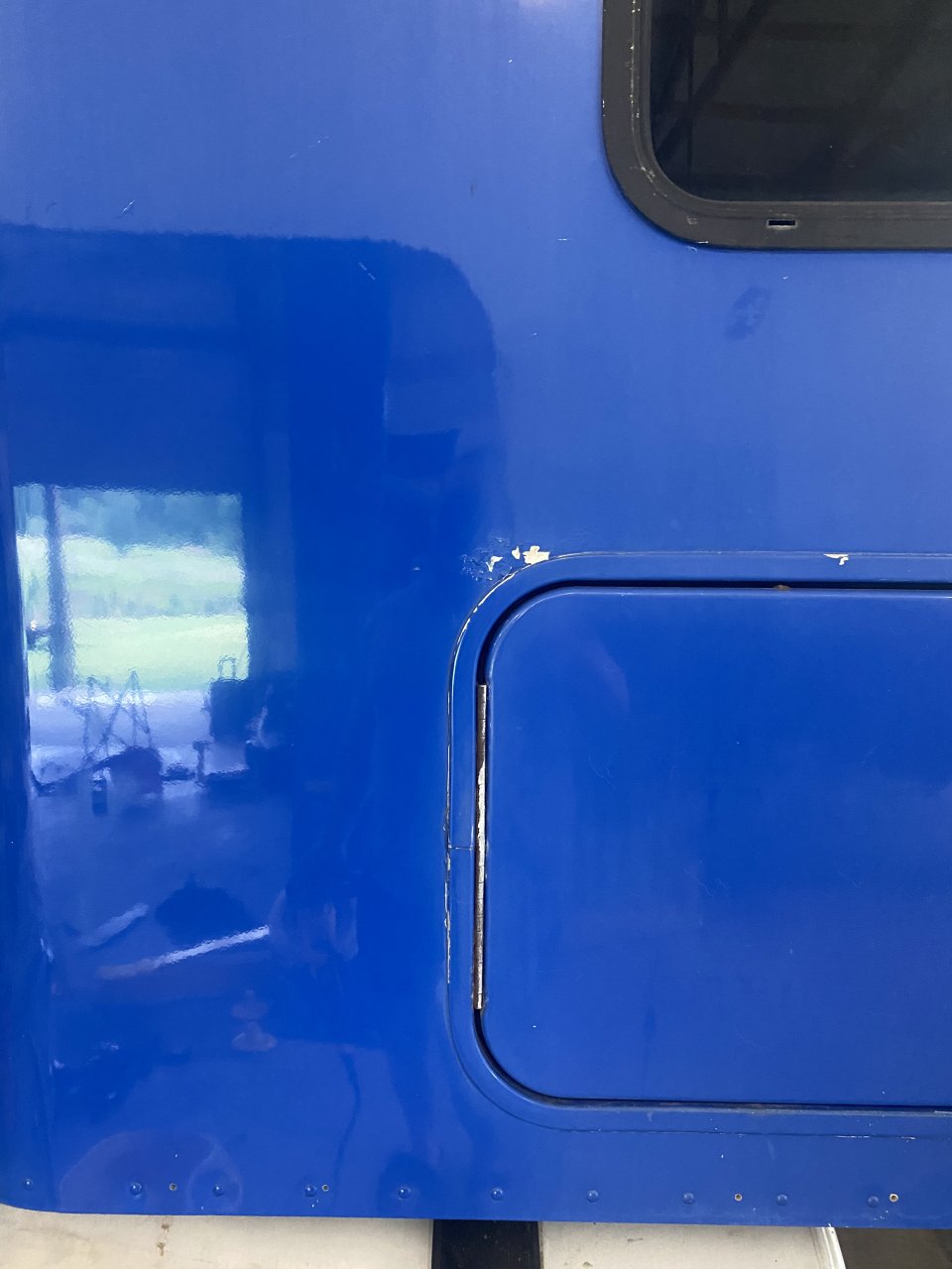

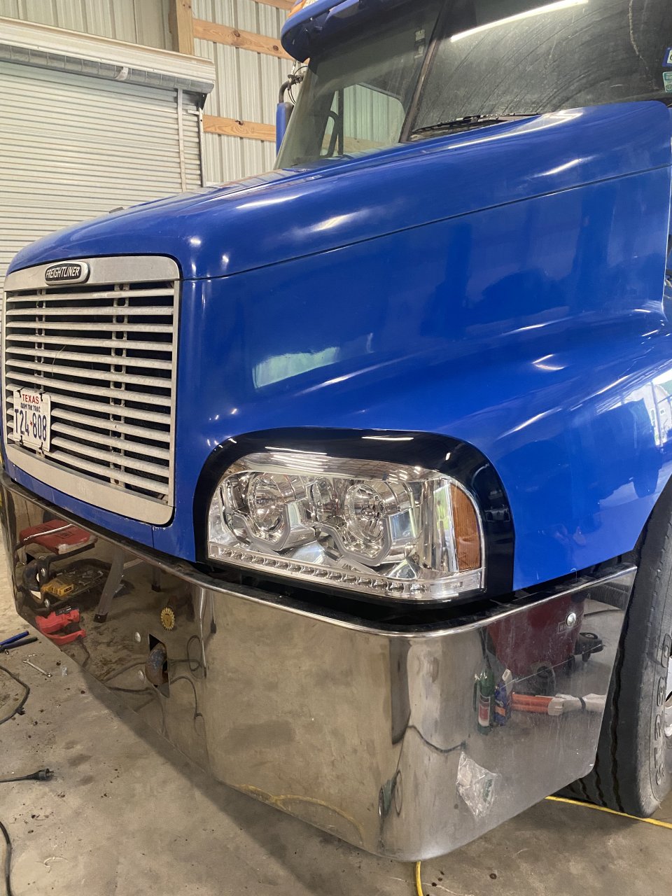

    Bought some chemical guys cutting/polishing compound and in a few test spots, that stuff is the real deal. Completely removed the years of ghost lettering from different stages of oxidation. Also got the headlight removed and new ones wired up. Every single nut was stripped in the light housing and was a nightmare to cut out. Passenger side was hard wired. Wired a plug back into it this time.

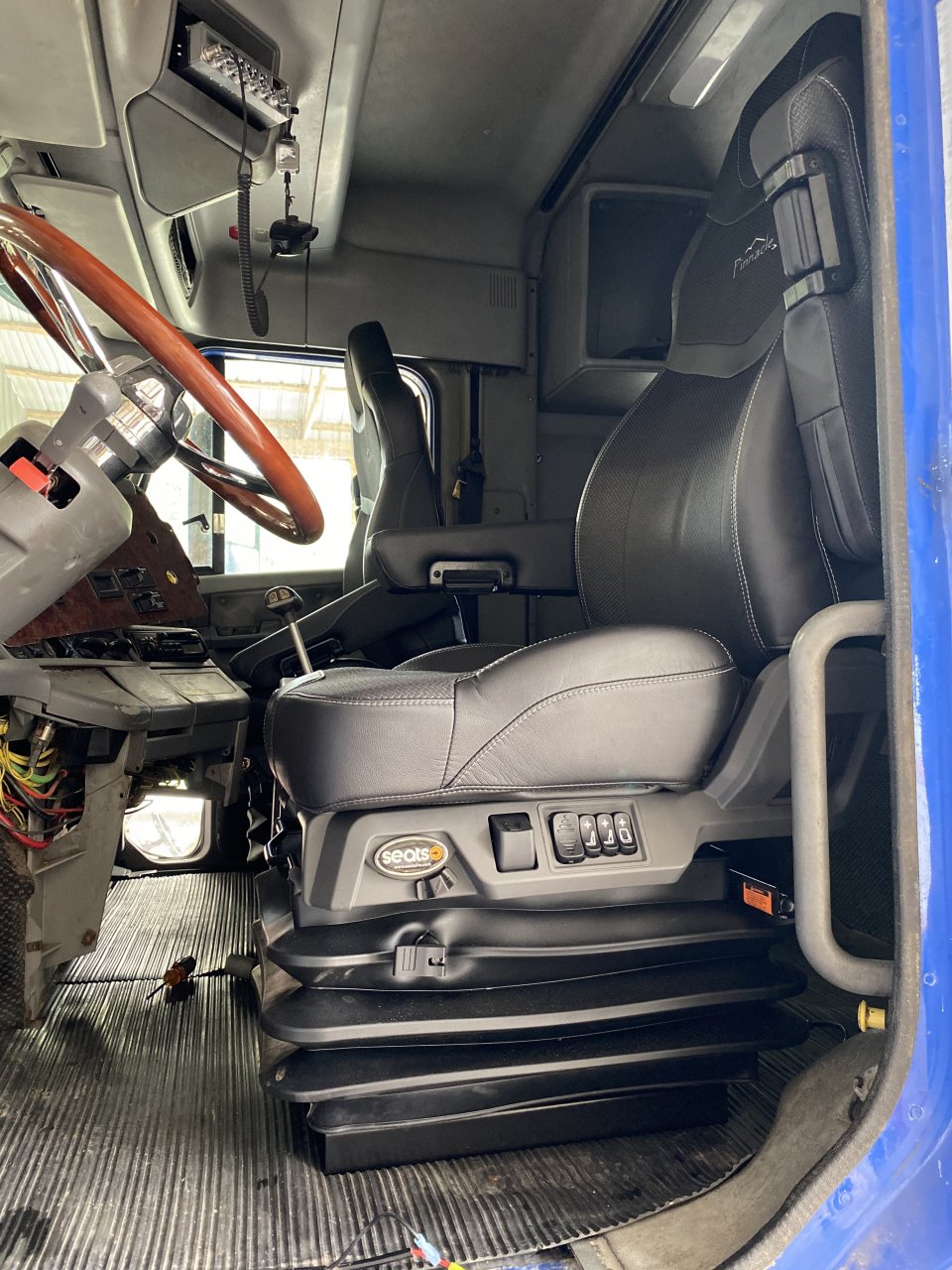

    Made a bunch of progress. Interior is coming along, been working on restoring the paint and very happy with the outcome. Next step is super singles and tackling the new A/C
