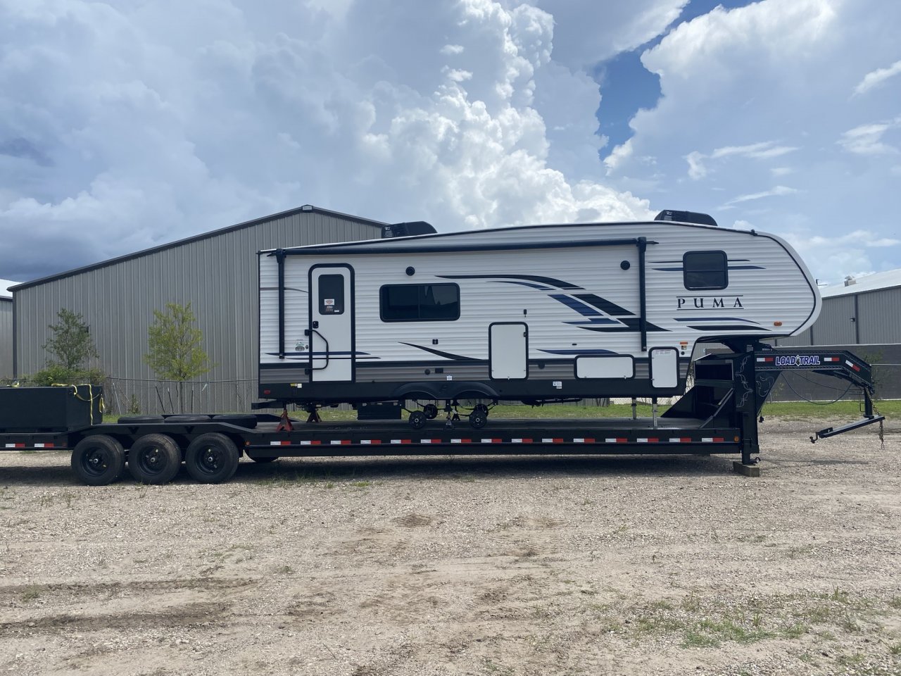

    Haven’t updated in a long time. We’re on the tail end of our month long trip. This is how the trailer and camped ended up. Truck weight with the frame only for the flatbed was a hair under 16k. We’re around 42k going down the road.
    Ended up adding a Coleman 13.5 rooftop AC to the tractor too.

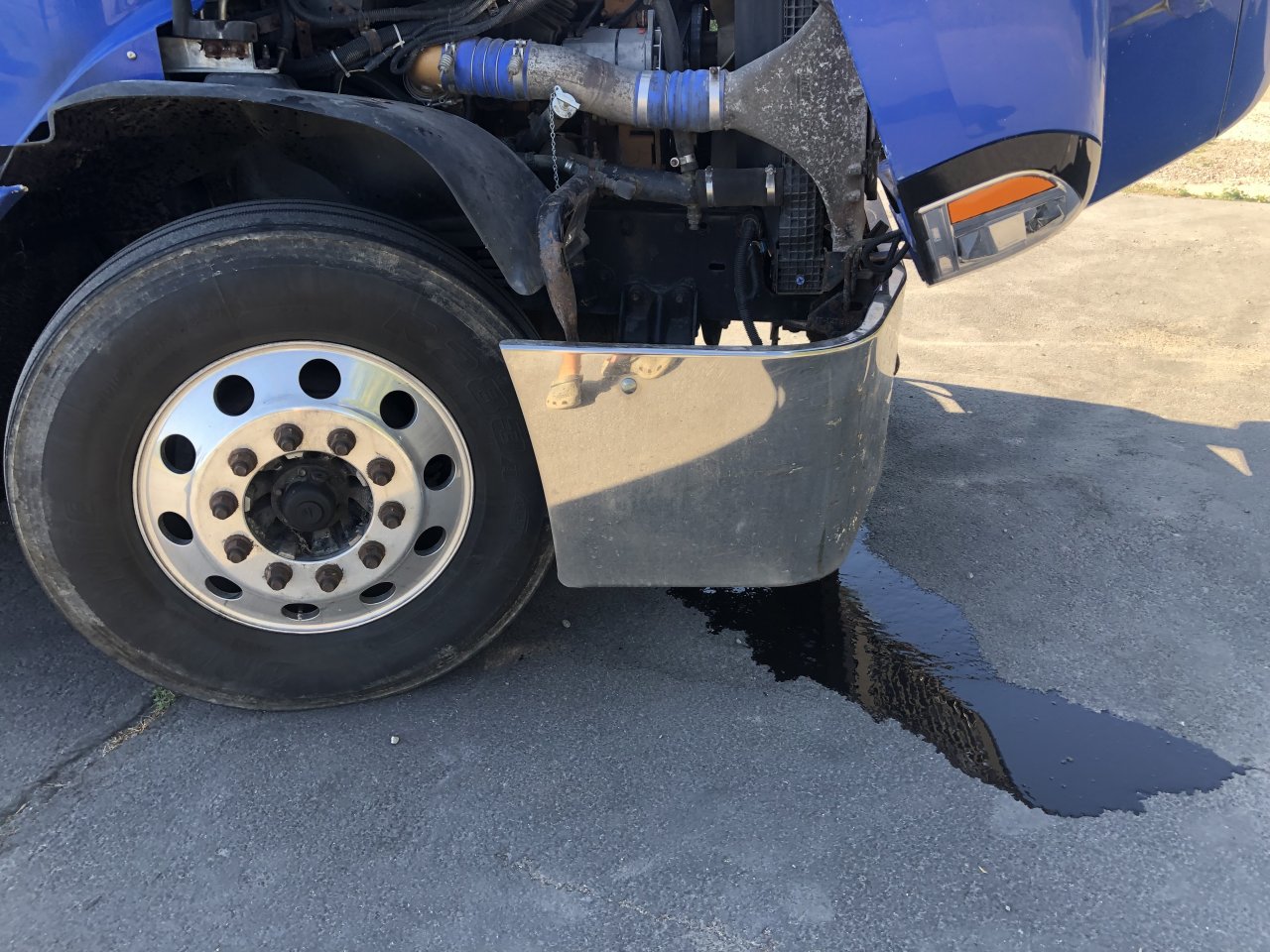

    Nearly had a catastrophe pulling into the campground near glacier natl park. Long story short truck was dumping oil. Luckily it only started 1 mile from our stop after driving for 10 hours. The compressor bolts had backed out and it was dumping oil from between the compressor and block. Tightened them up and added lock tite. 4 gallons of oil later we were ready to roll again.

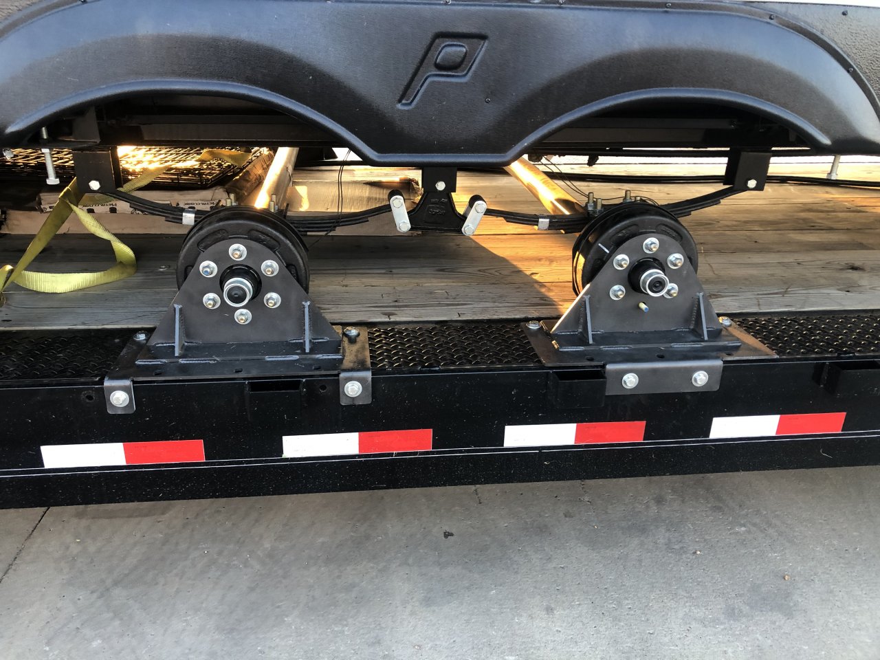

    I was wondering how you secured the trailer--pretty slick bracket setup!!
    rustyshakelford Thanks this.
