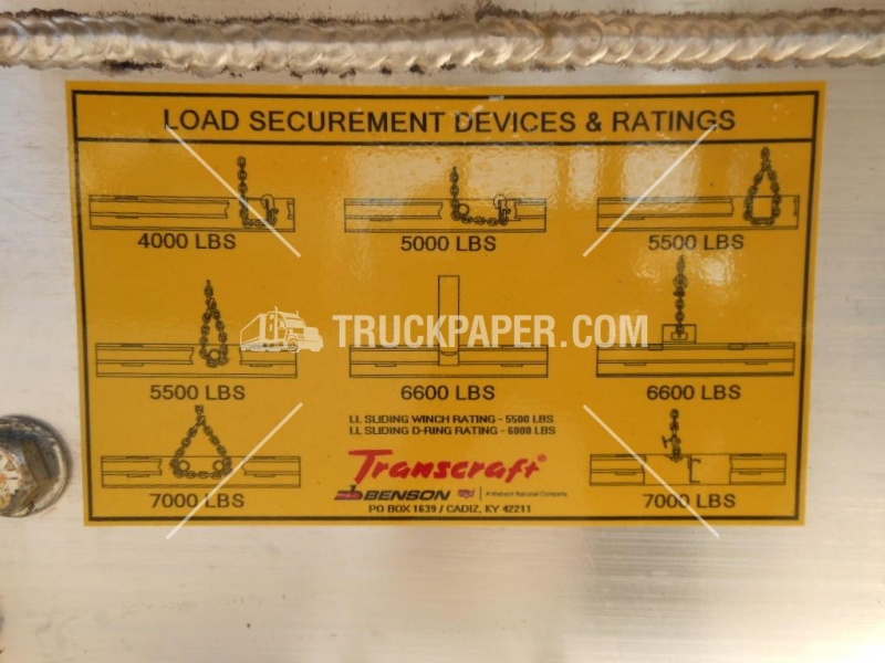

  10. 15 over
    15 over Light Load Member
    84
    45
    Jul 1, 2013
    Mobile, Al
    It appears we all may be wrong, I found this while looking for an answer, it is a load chart off a brand new Transcrap. It shows the load rating actually increasing by hooking the chain back to itself. It also shows the load rating for hooking straps to the rub rails.
    Maybe I was wrong but I sure thought I remember having that question when I took my Alabama coil haulers test. I did look but could not find an answer either way, this chart is the only thing I have been able to find in writing.
