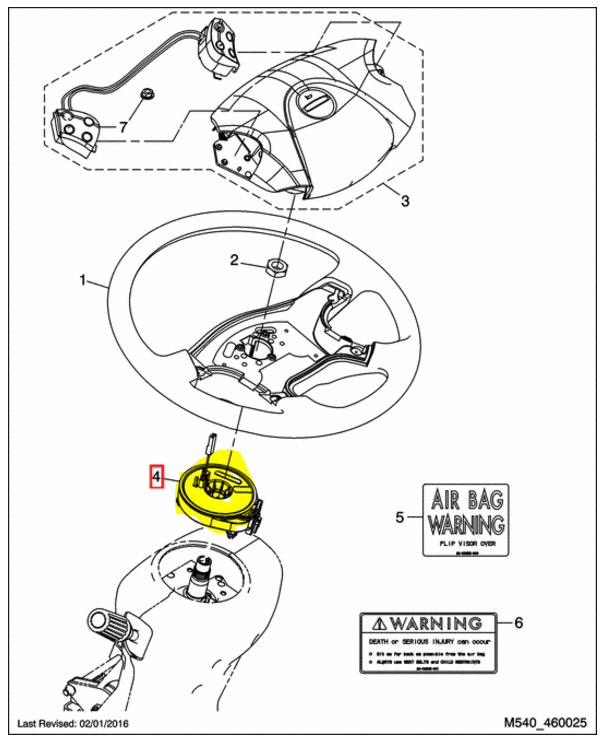

    Hopefully this saves someone some time. Had a unit where the engine brake & cruise control stopped working. Hooked up to DDDL, Switches from the steering wheel were missing. It ended up being the Steering wheel clock spring.
    Removed steering wheel, follow the instructions on the spring clock, ensure your wheels are straight, install the part, reinstall steering wheel, and problem solved! I hope I save someone the headache and some money. Part runs about $100.00

    Ya...easy. Did you check your ServiceLit? Here's a copy (hopefully it copy+pastes correctly):
    Steering Wheel, No Airbag
    Removal
    1. Position the front tires straight ahead. If possible,
    drive the vehicle in a straight line for a short distance,
    stopping at the spot where service work
    will be done.
    2. Park the vehicle on a level surface, shut down
    the engine, and set the parking brake. Chock the
    tires.
    3. Remove the steering wheel cover module by prying
    its corners away from the steering wheel and
    pulling the module out.
    4. Disconnect the horn and steering wheel switch
    connectors. See Fig. 1.
    IMPORTANT: The steering wheel does not have
    threaded wheel-puller holes. The tapered fit between
    the steering wheel and the column is designed
    to be removed by hand.
    5. Loosen the nut that holds the steering wheel on
    the steering column, but leave it on the shaft
    until the wheel has been released from the tapered
    fit.
    6. Remove the wheel from the tapered fit by striking
    it from below, at the rim/spoke intersections, with
    both hands.
    7. Remove the steering wheel nut and the wheel.
    Installation
    NOTE: Before installing the steering wheel,
    make sure the front tires are pointed straight
    ahead, and that the steering gear is centered.
    1. Turn the clockspring cover clockwise until it
    locks, then back off counterclockwise four turns
    and align the clockspring marks.
    2. Thread the switch and horn wires through the
    hole above the center of the steering wheel, and
    set the steering wheel on the steering column;
    see Fig. 2.
    3. Make sure that the steering wheel is oriented as
    straight as possible.
    4. Install a new steering wheel nut and tighten 33 to
    41 lbf·ft (45 to 55 N·m).
    5. Connect the steering wheel switch and horn connectors
    to the steering wheel cover module.
    6. Install the steering wheel cover module into the
    steering wheel.
    mhyn and QUALITYTRUCK Thank this.
