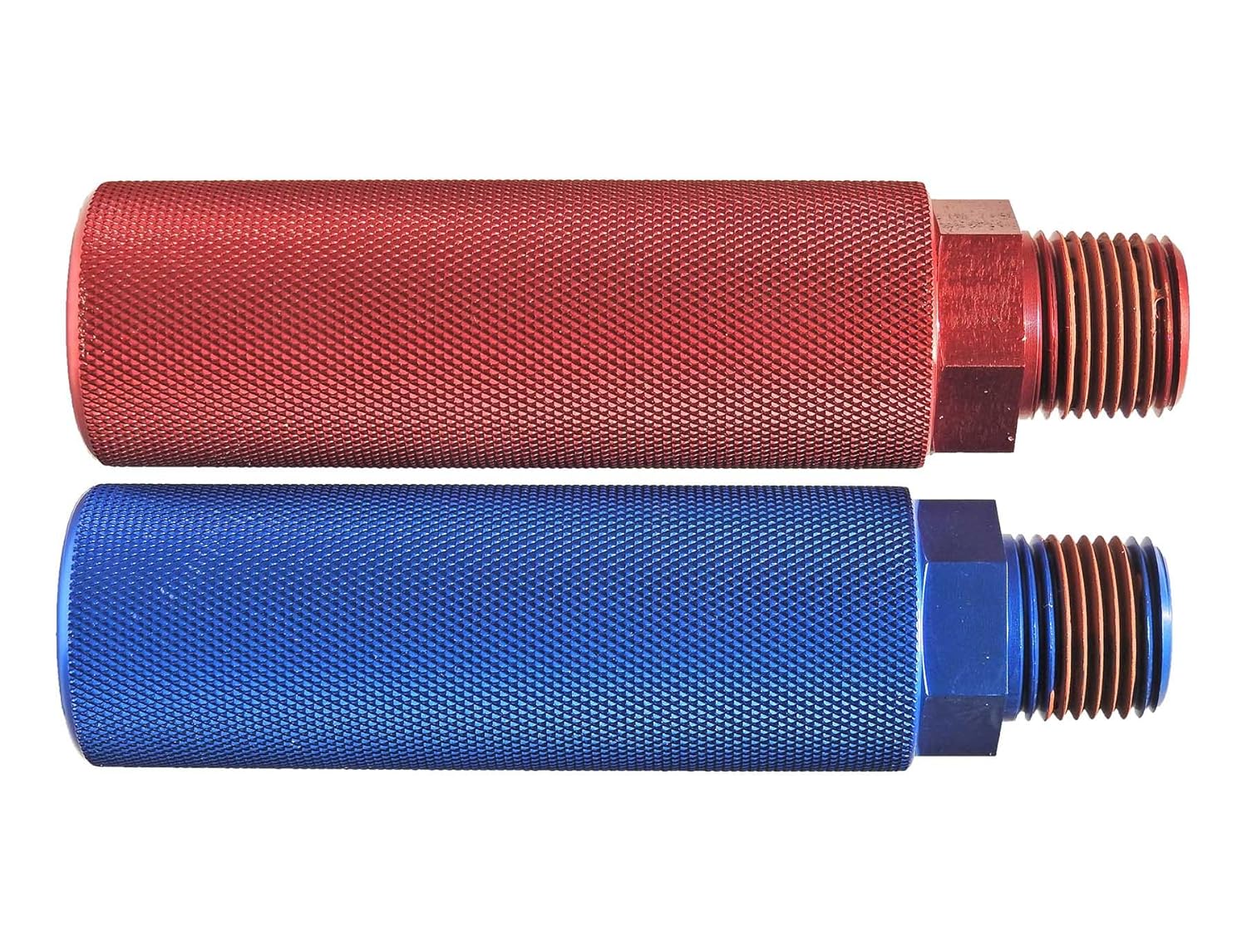

    Handles will secure them as well. $20 bucks or less if ordered online.
    Makes the lines easier to handle { a lot of drop and hook in the ice makes having them a necessity} and prevents pinching at the glad hand.
