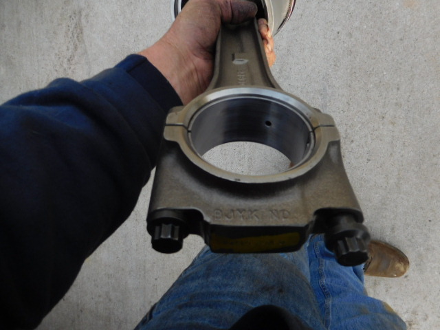

    This is the 1986 Big Cam 4 I am going through at this time. Notice the deformed aftercooler? This is low flow, but it won't be when I'm finished, and it won't be stock neither, I'll just leave it at that....;) It is suppose to have only around 10,000 miles on it and so far, everything I have looked at from the rear main bearing, to the heads, to pulling #6 piston says the mileage is correct on the in-frame. Everything looks brand new, and is all Cummins parts. Enough about my junk :).

    You need some paint on that block. Gotta make it look like it only has 10k miles on it.

    LOL... Oh yes, when I'm done it will look all brand new. I was told it had been used for about 10,000 miles after the in-frame then parked for little over a year. Just covering all bases before it goes in the frame rails.
