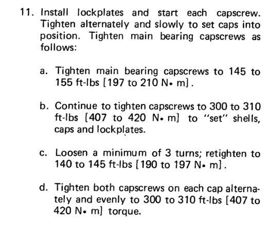

    So upon reaserching for the main bearing replacement I'm looking to preform, the old shop wizard scanned me his 855 shop manual. According to the manual the proper sequence is:
    Tighten to 145-155FT-LBS
    Continue to Tighten to 300-310FT-LBS
    Loosen 3 Turns
    Retighten to 140-145FT-LBS
    Tighten both cap screws on each cap alternatively an evenly to 300-310FT-LBS
    Screenshot_20250706_235113_M365 Copilot.jpg Screenshot_20250706_235113_M365 Copilot.jpg
    However over on scribed I found different instructions: Screenshot_20250706_232049_Chrome.jpg
    My engine is a Gen Four according to the serial number which indicates it was manufactured in '89 (what I believe is) the last year before they quite production on the 855 and moved onto the N14 Red Top. The Pete was manufactured sometime in 11/'89.

  3. Star Rider

    Do the 1st three, you will be fine.

    The sequence is the same on all Cummins 855’s. The torque ratings are different depending on the bolt/stud diameter. I have seen many that don't have the lockplates from the factory. Many old Cummins guys have said if it don’t have them don’t install them.
