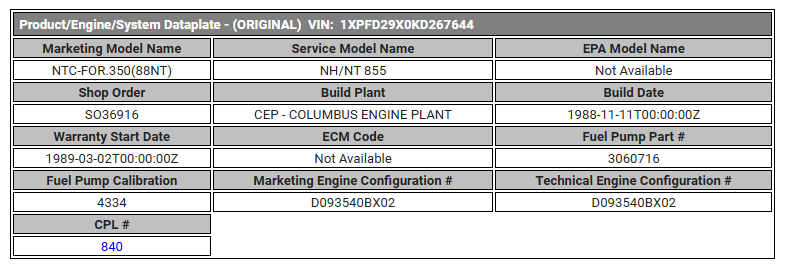

    Can't help with the other stuff, but here is your dataplate off quickserve.
    Hilltop Hustler Thanks this.
