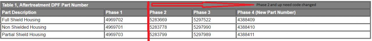

  7. 4vmach1
    4vmach1 Light Load Member
    184
    72
    Apr 3, 2013
    Los Angeles, CA
    This is what I found on the DPF
  8. Strange77
    Strange77 Light Load Member
    59
    36
    Oct 1, 2011
    Yea 5297522, that's phase 3 and you will need the AV10224 code as long as that code was AV10065
