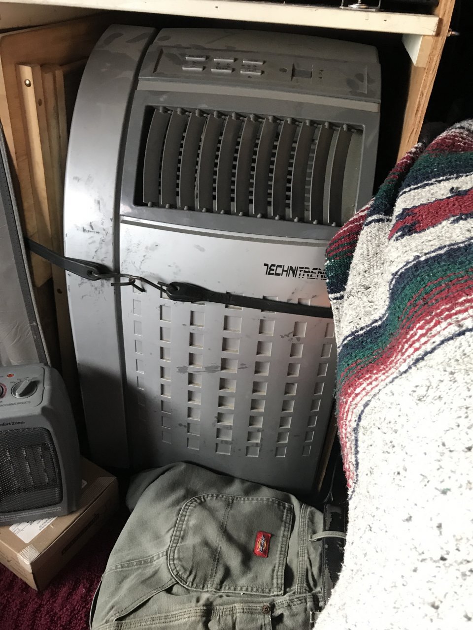

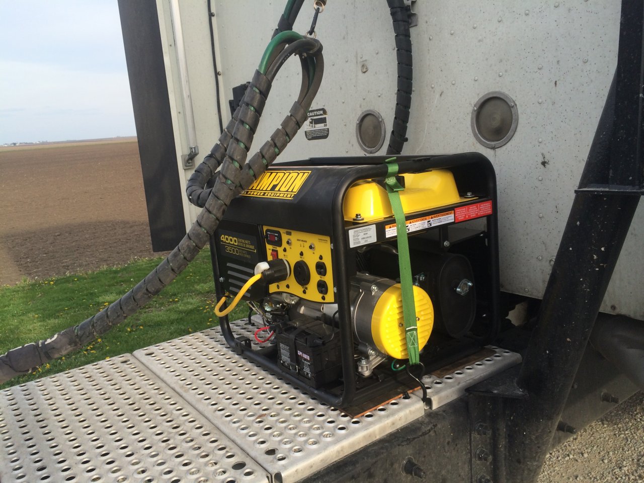

    Best investment I ever made in trucking. Remote start, you can get 14 hours on 3 gal of gas. $399 shipped to my door. 3BE4BE92-75F8-4591-9707-72514AACBB4B.jpeg image.jpg Get a room AC unit (dual hose not single) and a little plug in heater from Walmart ($15). I carry a 6 gallon gas can in my headache rack and the generator in a side box now. I have an ISX and bump it up to about 750 rpm. That usually get the oil pressure up to about 30 lbs. I avoid idling like the no ones buissness. I have run a few weeks without my gen and I cost me about 1 mpg to idle for the week (1800 miles 6.68 down to 5.5) as opposed to less than 10 gal a week in gas 4 long nights a week.

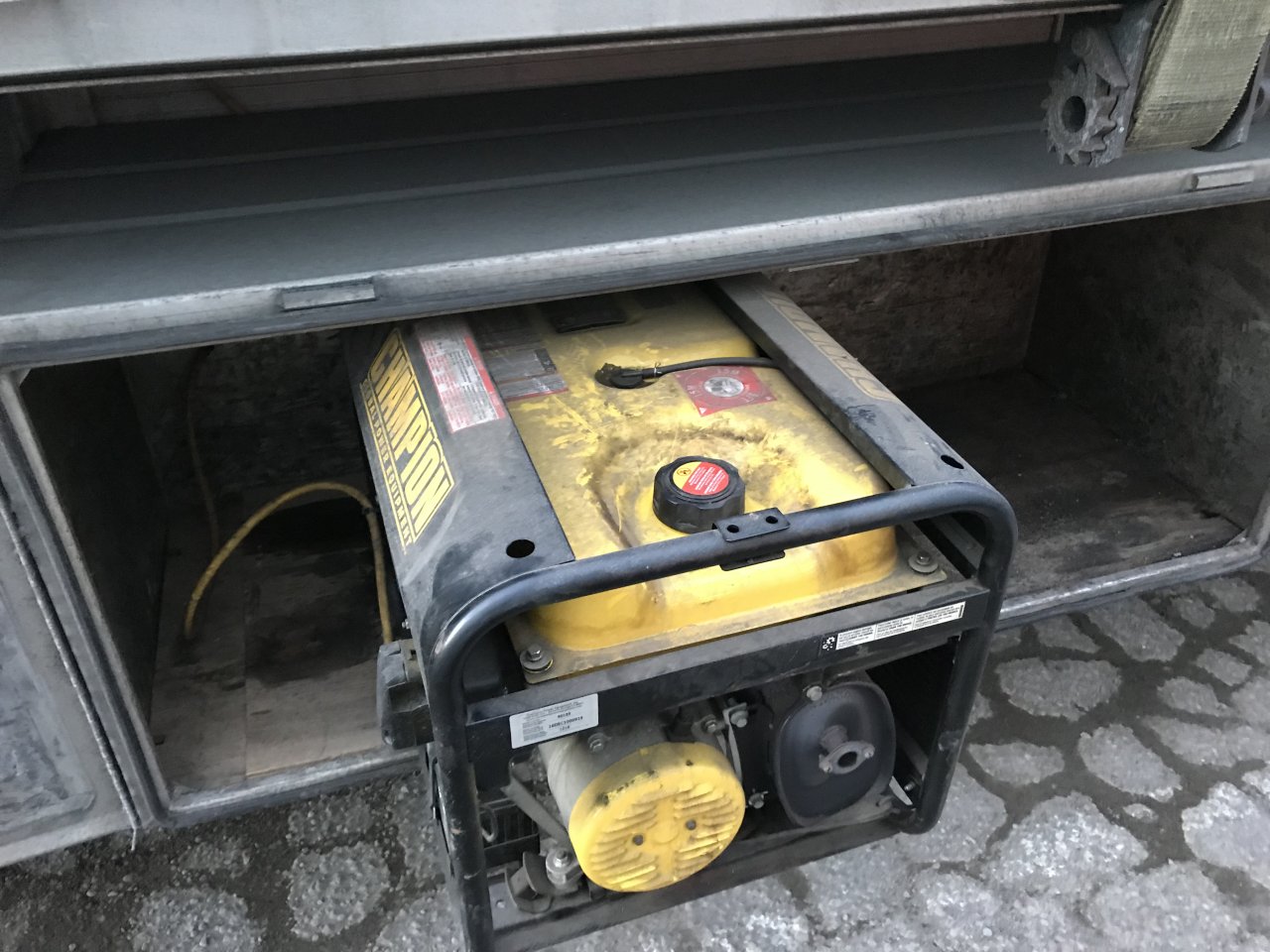

    Do you have any pictures of how you have it set up now boxed in ? Also how many watts is that and does the dot give any crap for having it or having gas ? I don' have my hazmat thanks.

    Cord runs up to a twist lock plug with air hoses and light pigtail. It’s in a regular tarp box (24 x 60) can’t even hear it running. I have it bolted in the front left corner so it swings out to fuel up. No problems with DOT. I think you can haul 60 gal or something before it’s an issue? Of course it’s all out of site now but never even questioned when it was on the catwalk. I think it has to have a fuel shut off (it dose)in order to be compliant. EAE1B317-A49D-4B2E-8ABB-443858911F10.jpeg 1C35F9AD-B57C-4FEB-AD63-500C110EA010.jpeg
