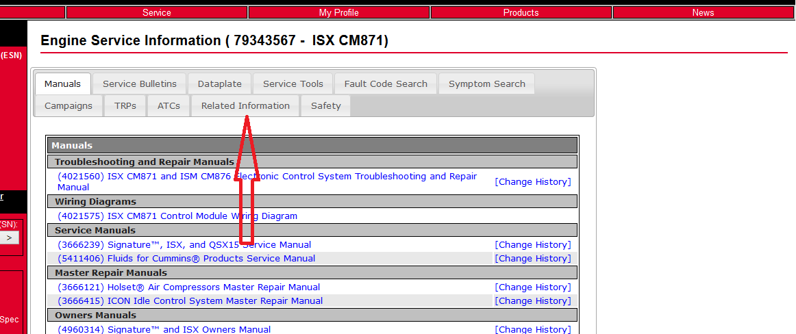

  7. Snailexpress
    2,675
    6,069
    Apr 28, 2014
    Rocky
    You have access to cummins quickserve just go to service/then click RELATED INFORMATION button.
    In next menu click SPN/FMI to CUMMINS FAULT CODES.
    Type your code PID94 FM0, cummins code will come in next row. Click the search button for this code and read information what and where and how.
