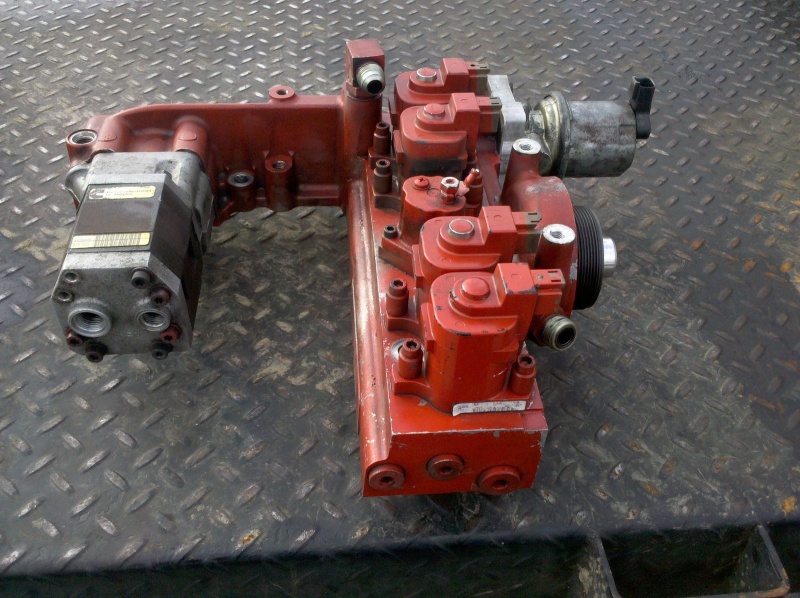

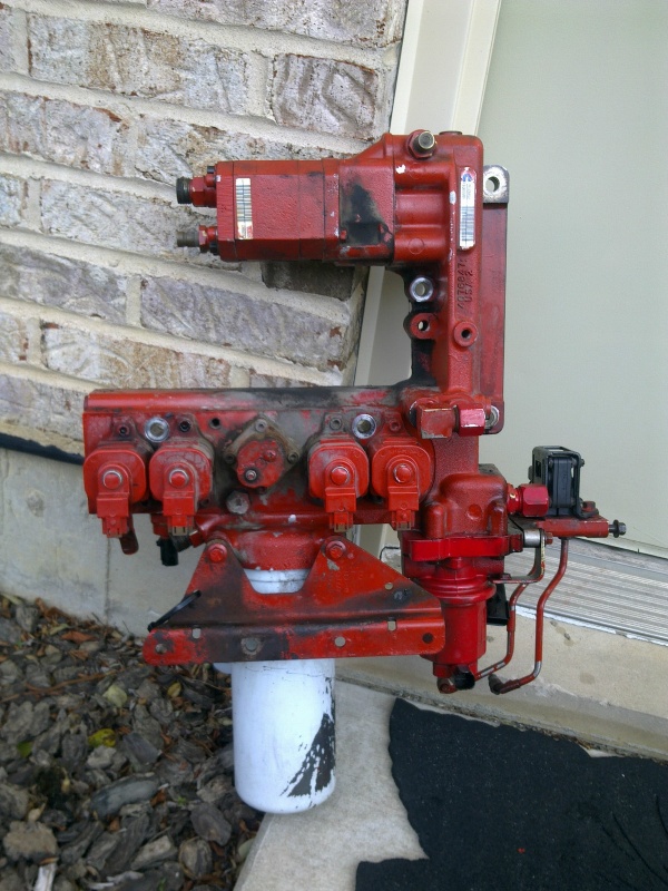

There are 2 metering and 2 timing actuators on the left side of your engine , that control fuel pressure to your injectors . The injectors are pure mechanical. If you are getting a low fuel pressure code , and have changed the fuel filters , I'm guessing its probably a problem with the actuators .

no i do have a INSIT but dont have a adapter .....my shop does, with turbo replacement i changed oil plus all filters ....Pawpaw you seems more knowlegable than me ,would you explain these actuators to me, are these 4 acuators on left side of engine on fuel pump housing??? they all have electric plg on the bottom ,right? whatt means 2 are timing and 2 are metering? whats they purpose ?? they never been changed in my engine ,i have 1,110,000 original miles with no overhaul by the way ,and everything seems original yet maybe its time for them,,,,about boost pressure its pretty low also in your engine ,cummins spec said needs to be in 36-38 psi range, lower boost cousing low pulling power, kill mpg, even heats up engine and components -more fuel than compressed air in air fuel mix going to engine combusion chamber...i will check CAC system this week as cummins spec said start from there

Actuators do just what the description of them says . 2 control the timing of the fuel delivery, one for the front three cyclinders , the other for the rear three.
The metering ones do the same. The ECM tells them how much fuel to deliver to each bank of injectors.
The injectors are pure mechanical. Actuated by the cam , I think.

Your low fuel pressure could be one of the two pressure regulators in the fuel housing, it could be your gear pump, or even air in the fuel. I do not think the actuators would cause low fuel pressure. Again, all I can do is guess.gregor Thanks this. -
