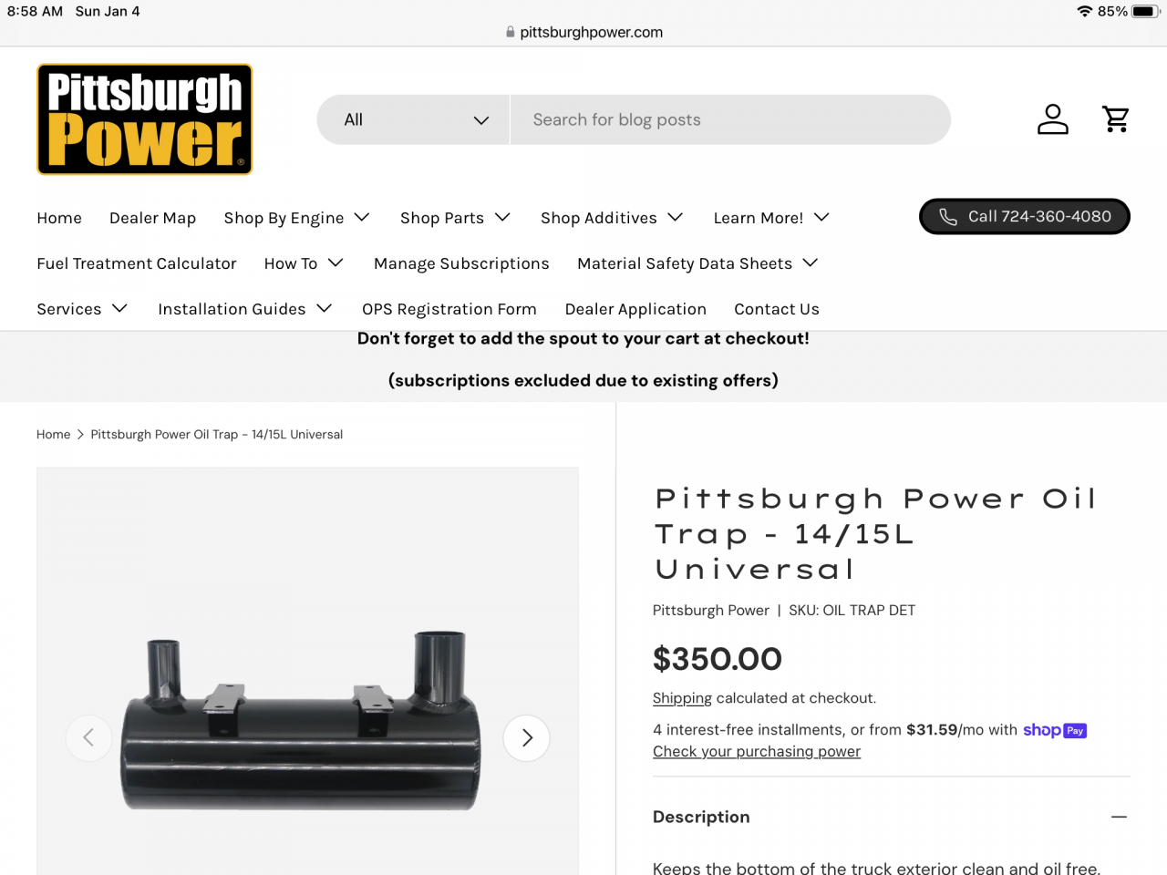

    My series 60 was terrible about blowing oil on the front side of my passenger fuel tank. I bought the Pittsburgh Power can and it has worked well. I bought mine 7 or 8 years ago and I don’t recall the price but it’s been worth what ever I paid to me. Not constantly having oil on my polished fuel tank would still be worth $500 to me, maybe not to anyone else.
    Google search shows $350 and someone with the time and skills could probably build one cheaper, I couldn’t. IMG_1390.png

    It just vents back to atmosphere correct? I just don't think there is anything specific or special about it that I can tell. Appreciate your reply.

    The can traps the majority of the oil and every time I change my oil I will empty the can using the valve installed on it. Then it vents to the normal blow by tube that blows significantly less oil in my case. Works as it was advertised to work. I spent a lot of wasted time trying to reposition and lengthen my blow by tube with no success because the oil comes out on something else. If I would have just bought this to start with I would have wasted less time coming up with the same final solution.

    Sounds good I am just going to try the cheaper version. Seems like it shouldn't be any different at all. I just don't see anything game changing about their design that is worth 350 bucks. I appreciate your feedback and maybe I will be wrong! We will have to see.

    Definitely nothing special about it. If you like fabricating stuff it should be an easy job. At this point in my life I pay for convenience.
