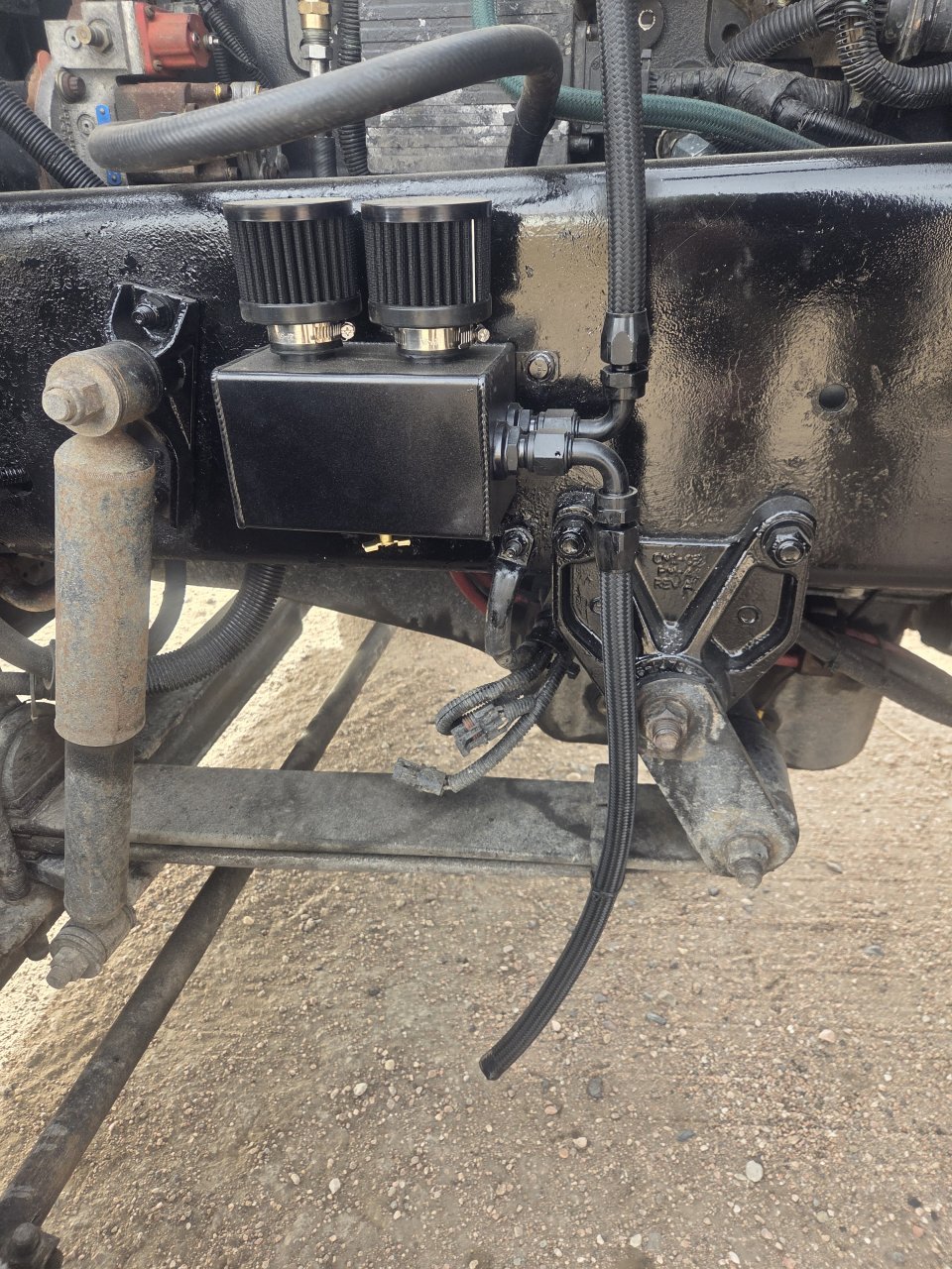

    Final result for anyone who cares. Seems to work good. Seems to breath just fine. No more oil slopping all over the place. About 60 bucks invested i believe. 20260113_093643.jpg

  10. Banker

    Looks like you need to start selling them. How much time do you have in it?

  11. Kruse Family Farms

    I ordered it online. Took maybe 30 minutes to install. I definitely don't need another business to run hahahaha.
