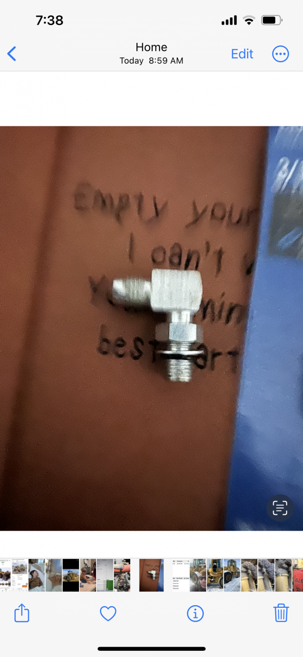

    Kenworth had a smaller check valve but I'm not sure where it goes. Is there a second check valve?

    Here is the smaller check valve

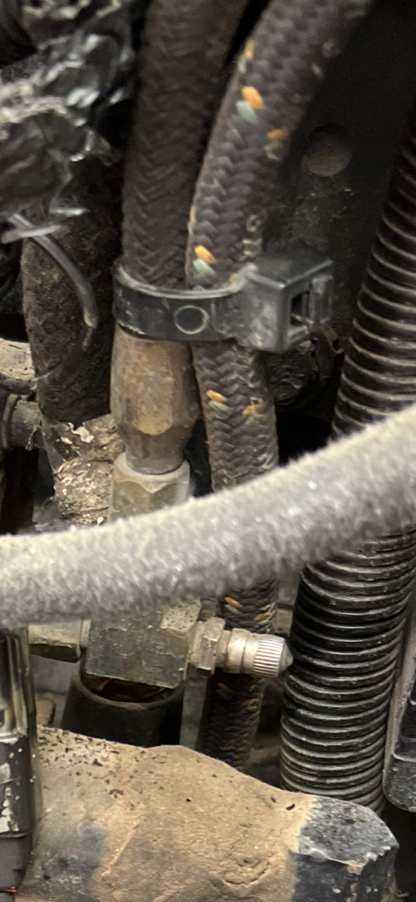

    There’s a compucheck fitting,but I don’t remember if it’s on the top or back of pump.

    Yes, I think this port on the rear of the pump is probably where you’re talking about. I’ll see if I can figure out my fuel pressure tomorrow. Maybe get have to get a gauge from somewhere.
    I’m guessing I have either a check valve I’m missing, a leak or obstruction in a hose somewhere, or pump that’s going bad. 9BC6FCA7-AD61-4429-8A6B-34282BA7FAD4.png
