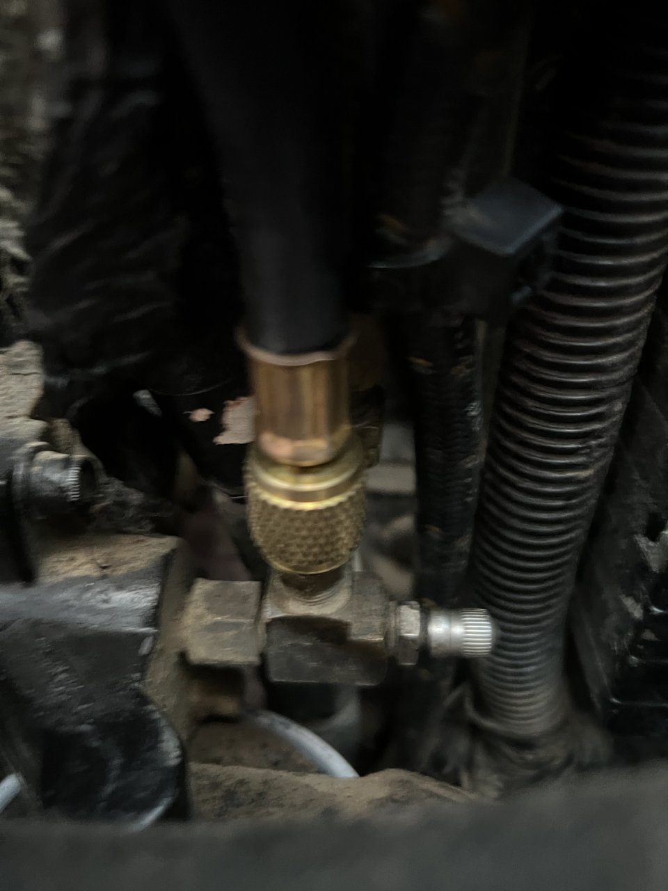

    I checked the pressure today in 2 locations. I checked on the line that runs from the pump to the fuel rail. My gauge only went to 100 psi and I was well beyond that. The needle was buried.
    but I tried on the little fitting on the back of the pump (where the line for my filter gauge is). I had no pressure on this line. Picture below. Shouldn’t that line have pressure?
    makes me wonder if something is wrong with my pump.
    I wasn’t able to try the bucket test. My battery got drained from starting the truck a few times. So I’m charging it over night.
