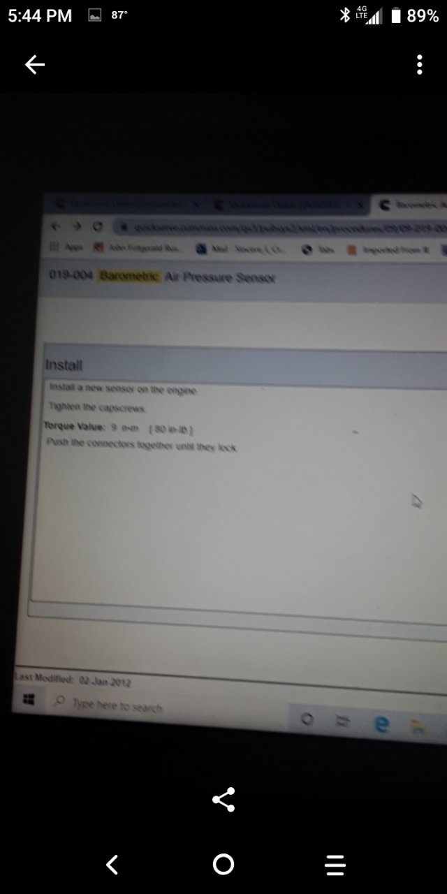

    Mine doesn't flash it says 019-004 barometric pressure sensor. Screenshot_2020-08-04-17-44-32-814.jpg

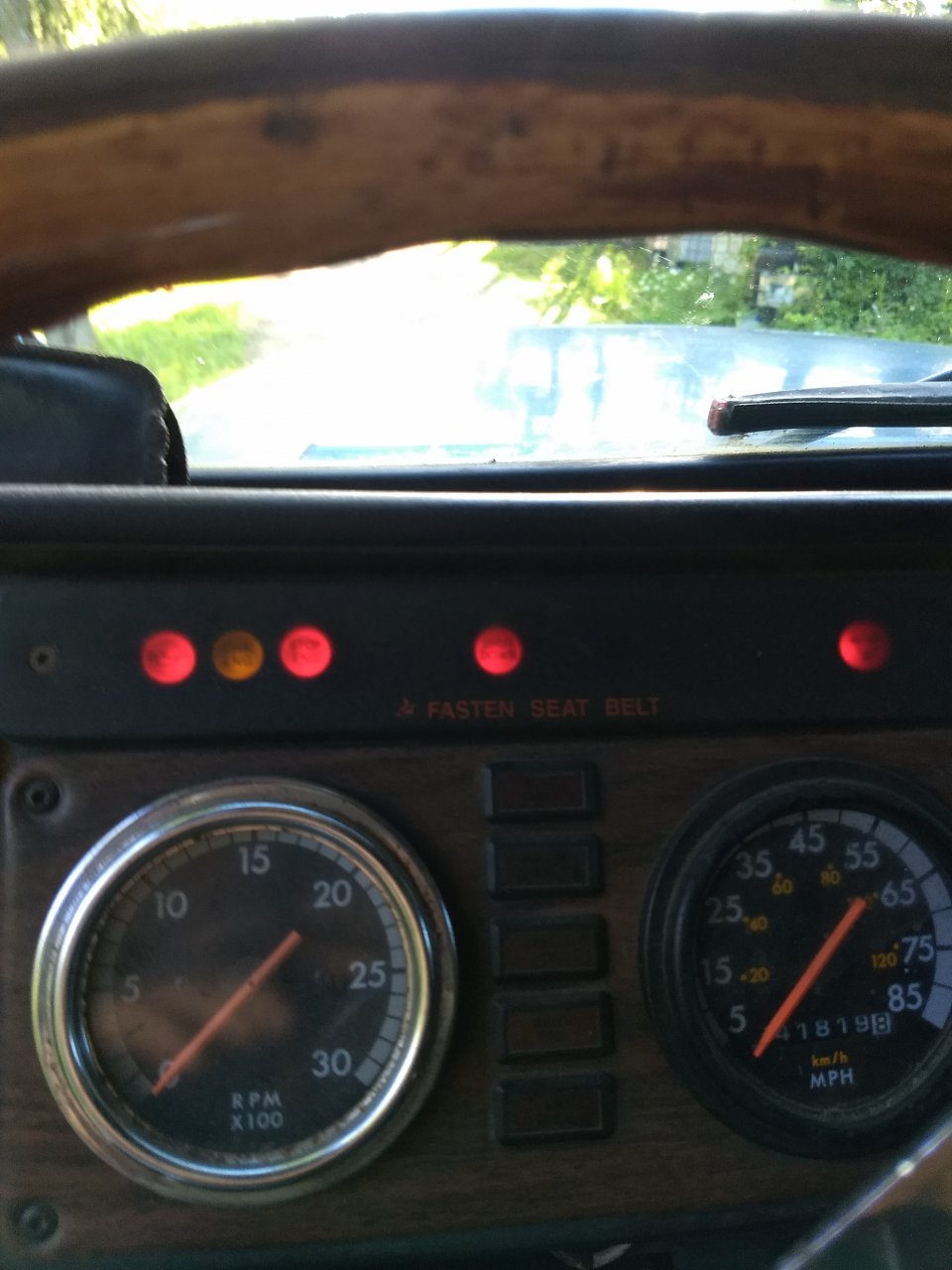

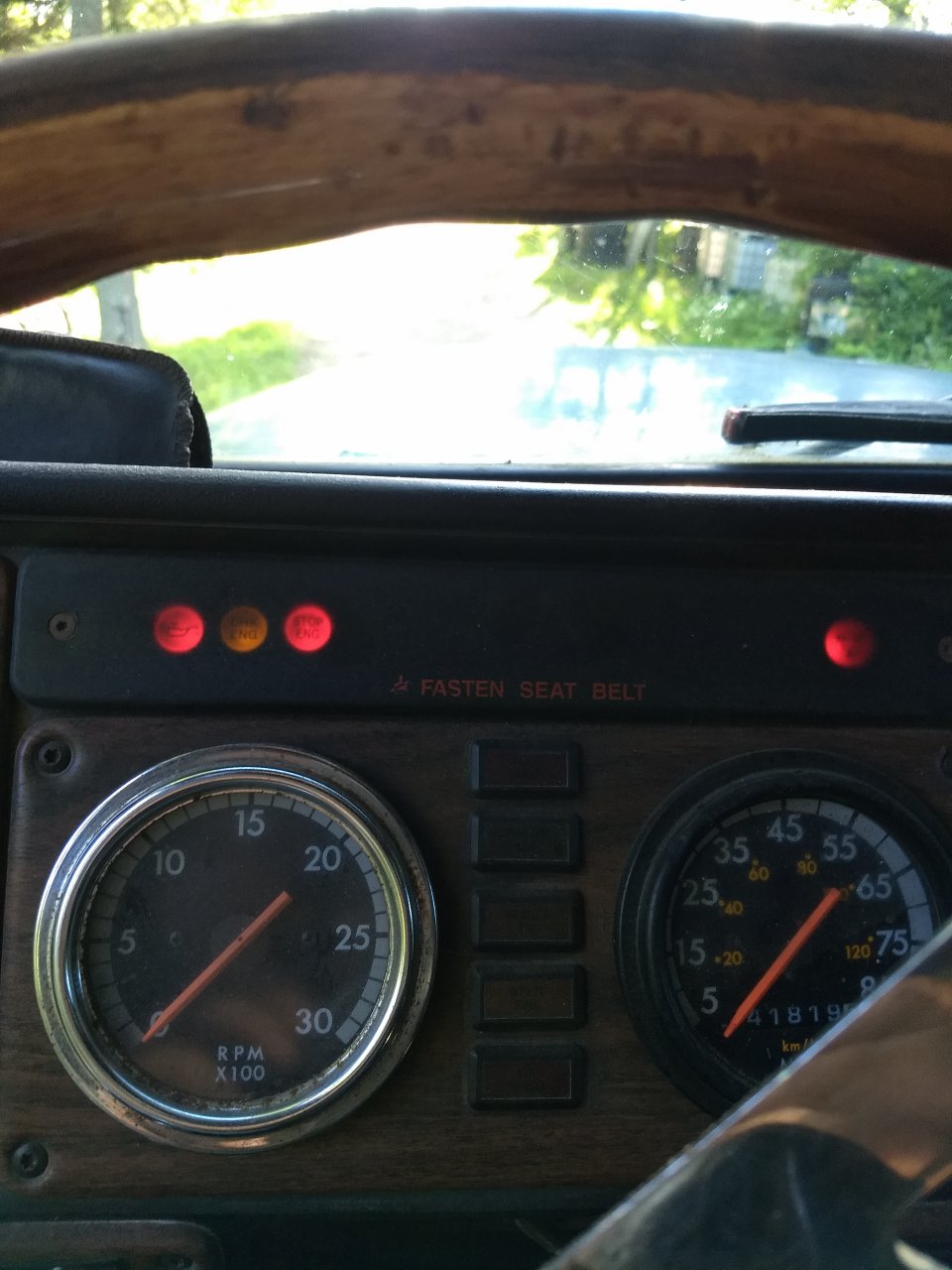

    Your picture is from a laptop?
    I mean the code the truck dash gives you.
    This is key on to start, don't push starter button. IMG_20200804_175657707.jpg
    This is after you hear the start up cycle.
    This is the switch for diagnostic.
    Bottom toggle switch very left side bottom of dash.
    The yellow CEL and Red SEL flash to give you a code.
    These pictures aren't in order. I hope you can understand the procedure.
    Search for "Cummins n14 code" you'll find a table for the flash codes.
    You changed the barometric pressure sensor and it still codes as bad?

  8. newguy704
    newguy704 Bobtail Member
    7
    Sep 19, 2012
    Actually the mechanic pulled the barometric sensor and I guess it went from inactive to active so he told me that that sensor was good and maybe the wire from the manifold pressure sensor to the ecm has a short. But looking at the computer that he was diagnosing with I think I need the barometric pressure sensor
