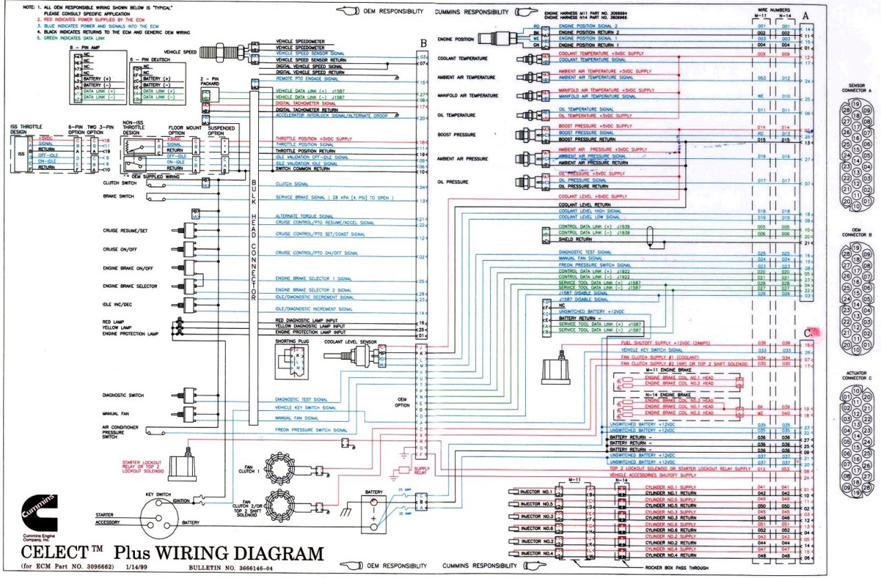

  4. xsetra
    xsetra Road Train Member
    5,199
    7,151
    Aug 21, 2011
    What truck?
    Do you get any codes from the ECM?
    Do you have a fuse on a ground wire from your ECM to the block?
    Search this phrase "n14 ecm troubleshooting"

  6. xsetra
    5,199
    7,151
    Aug 21, 2011
    I thought power should be constant to the fuel solenoid?
    If you're getting smoke while cranking it's getting some fuel, right?

  8. xsetra
    5,199
    7,151
    Aug 21, 2011
    When you put a jumper to the fuel solenoid did you have the original feed wire hooked up? Maybe the power was feeding back to a wire that has shorted out. Making the ECM give the red warning of death.
    Check the harness again. Could be a couple wires are crushed and shorting.
    Search this phrase:
    cummins n14 injector harness diagram
    Good luck
