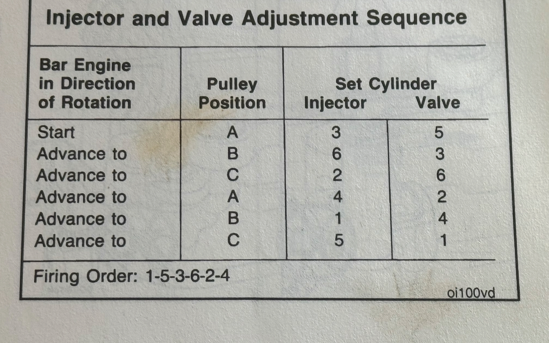

    Let’s start here….
    Roll the accessory drive to “B”, make sure it’s on B.
    Now check the valves on #3 & #4, which set of rockers are both loose, 3 or 4…?

  9. OLDSKOOLERnWV
    19,202
    290,484
    Big Cam is .011 on intake & .023 on exhaust.
    N-14 is what you are showing…

    The guy you have been talking to at Cummins probably wasn't even born yet when your engine came out.
    A lot of of us here were around long before.
    Use the chart @OLDSKOOLERnWV gave you.
    .011 on intake & .023 on exhaust. and 0 lash on your top stop injectors.
    Post some pics of the left side of the motor and valve covers if you want to verify.
