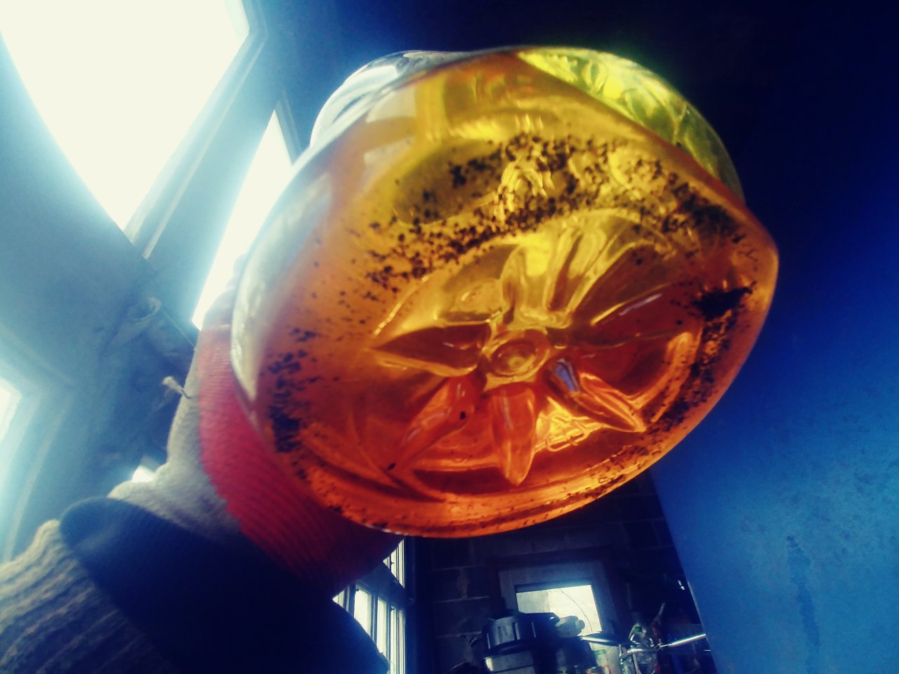

    I had the PT pump on my big cam 3 rebuilt maybe a month or so ago.
    The truck has only been run around my yard, not down the road yet.
    Initially everything sounded great and ran like it should. Then it began to feel like the accelerator was sluggish and it was harder to start, like it was losing its prime and sucking air.
    It's continued to get worse until now it's acting like full-blown sucking air. If you accelerate there is no acceleration. If you hold it to the floor for a little bit and take your foot off then the engine will soar on its own and come back down and wants to stall out or it will stall out. As it idles the engine just surges.
    I gravity fed it with a fuel can from up high, with the same results. The fitting with o ring that connects into the filter housing is brand new. I also put a new fuel filter on. So at this point the way I see it, either the fuel filter housing is cracked or the pump is having a problem. I do not think the housing is cracked.
    When I took out the old filter I dumped it out and dirt did come out of the filter. That's the picture I've enclosed. I did drain some fuel from the bottom of the tank and some crap did come out but it didn't really seem like that much. But there was dirt that came out of the filter. I put the engine into this truck, and I did not think there could be any problem with junk in the tanks, or to completely drain them before I started it.
    I am going to take the pump back to them tomorrow. Before I run the engine again I'm going to completely drain the fuel tanks and figure out how I can flush them. But here is my question.
    Could dirt have passed through the filter and gotten into the pump? How much dirt will that filter filter out?
    That engine only ran maybe a couple of hours if that. Could dirt really have gotten past that filter in that short of time and caused this problem?

    When you removed the filter do you remember what the fuel level in it was? Should be 3/4 to the top if normal. Well not be full. Also this is a subject of dabate but in all the old Cummins shop manuals they tell you to prefill all the fiters to the top when replacing and not to install them dry. so it can instantly run and work the air out of the system faster.
    Could be it needs to work out air if all its been doing is a lot of idle and no road running. Some are pretty quick and Some take longer. Throttle it up to 1500 or so and see if it starts to clear. Any time you crack anything loose on fuel system you introduce a little air which will cause it to stumble for a while.
