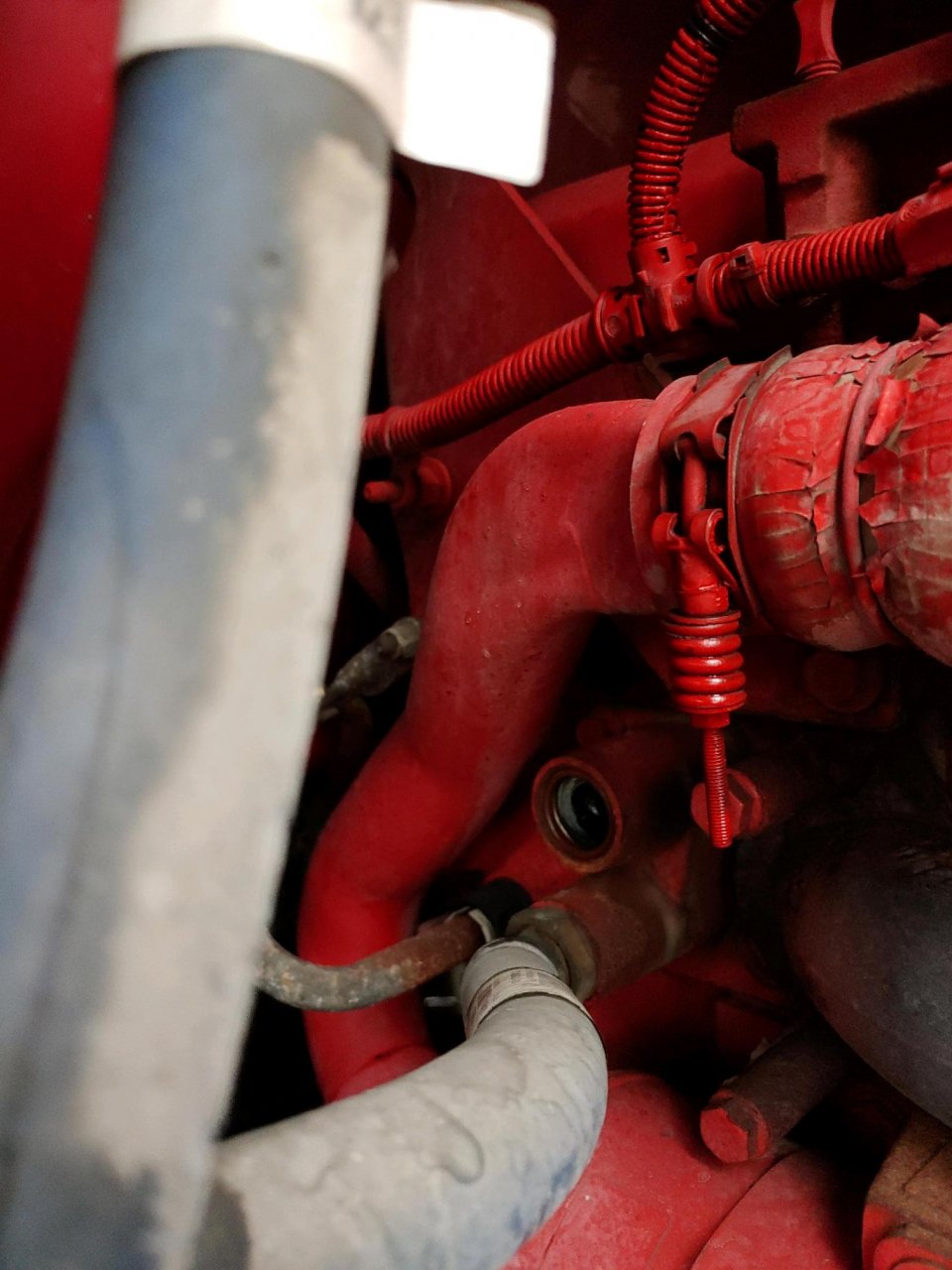

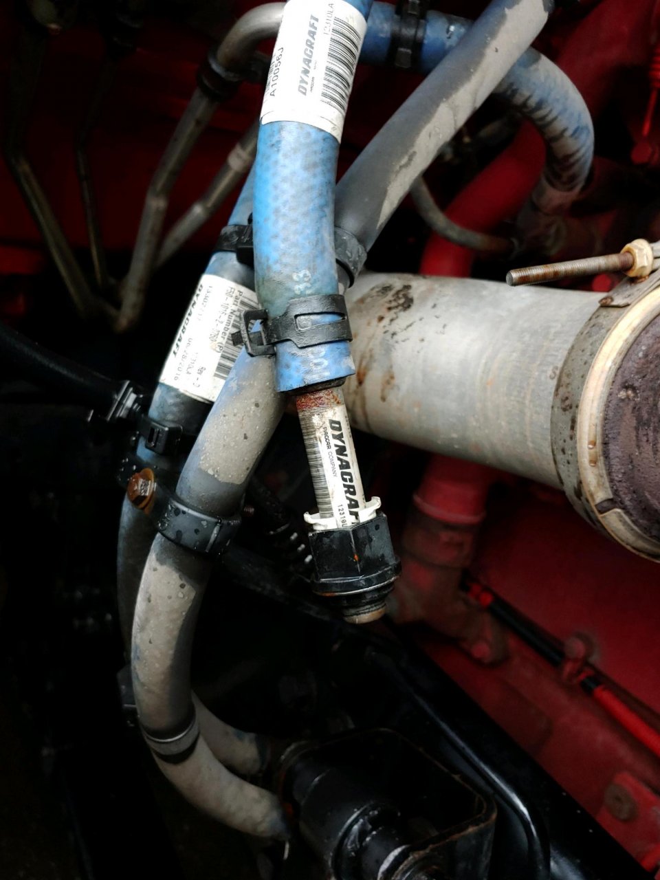

    Here you go.
    45D415E9-1876-48B2-A32E-590730183493.jpeg 6DBAD623-E510-48DD-B2E2-EFB6AA6AA313.jpeg
    This was on my 2018 T680. I checked the 2019 and both 2020’s and they have the plastic as well. So, updating them all to the metal as it’ll just happen again. This really should be a recall IMO. My contact at KW said he sees this happen every week. Hope this information helps someone.
