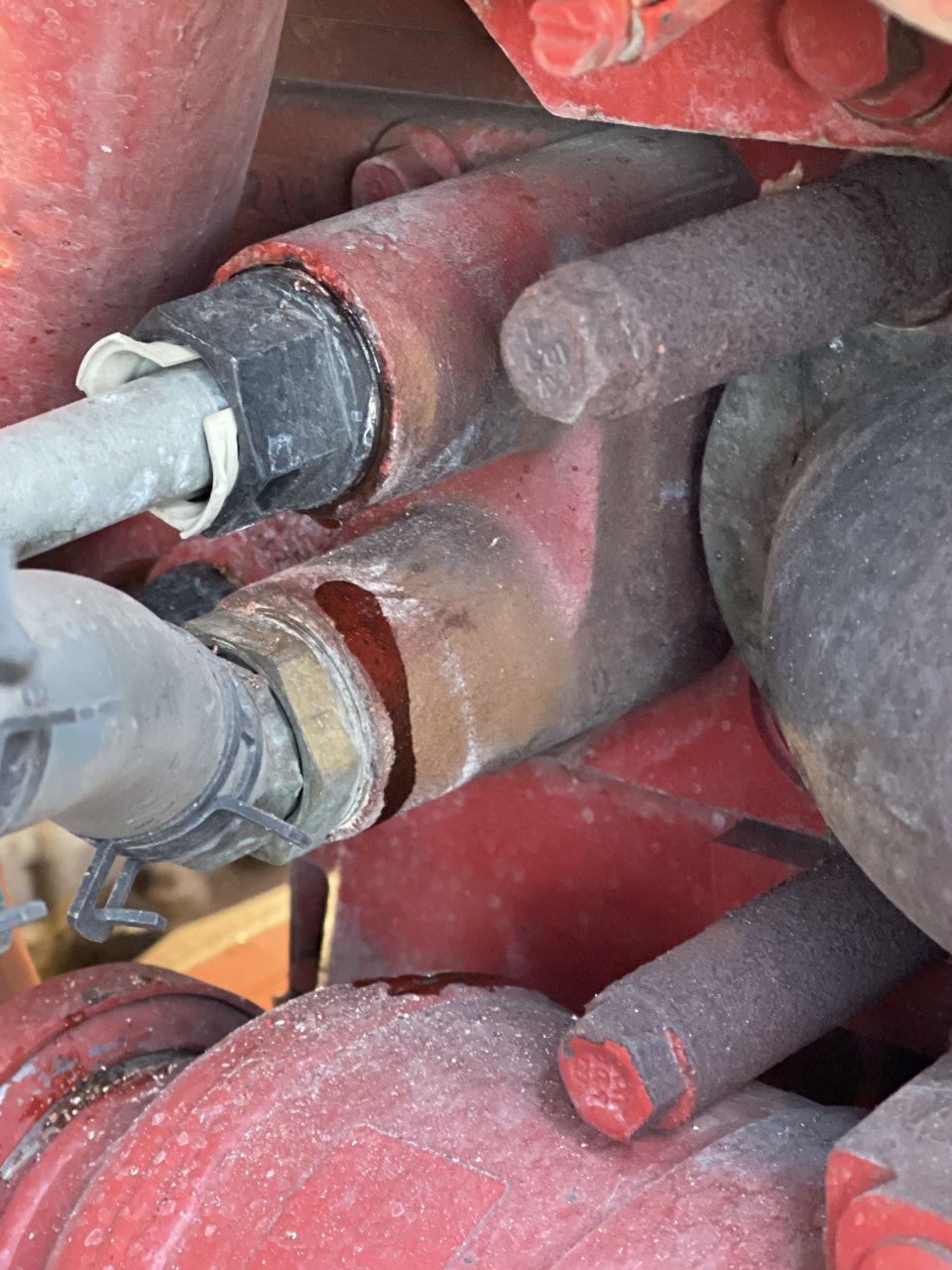

  10. Woellerindustries
    Woellerindustries Bobtail Member
    1
    Nov 11, 2021
    Which size would I need for a 2019 KW T680 Cummings X15
    the top one is obviously leaking.
  11. Goodysnap
    Goodysnap Road Train Member
    3,791
    9,229
    Jul 12, 2017
    Sure looks like the top one is 5/8” to me. But measure to hose ID or the aluminum tube OD to be certain. Get some extra hose to take up the length of the aluminum tube plus the other piece of hose.
