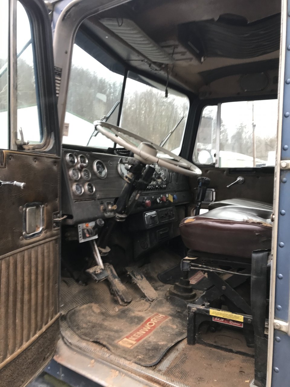

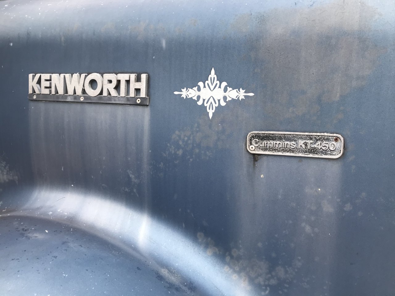

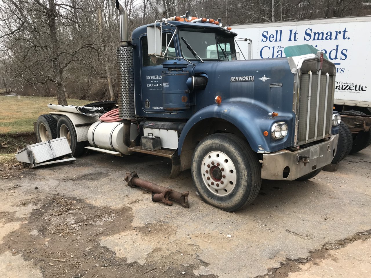

    Well, “he” is Rick at Rickys Heavy truck parts.....:) I could be wrong, but I’m thinking he is asking close to 20K for the A model. It’s a factory P/S & A/C truck with the factory KT in it, course the vision in the price I’m sure is the engine....
    CFF02C3C-EAA6-42E5-A6B9-A0631831549F.jpeg D607C8AB-8FD6-4BAD-9510-9971516D5758.jpeg C034C558-203F-4F07-8246-62CDBC21EB59.jpeg
