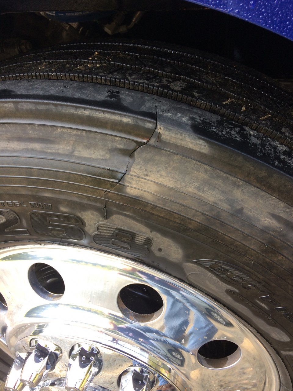

    Replace it.
    Toss that thing. Any kind of defects on steers get them replaced regardless of cost. You can have good steers if you value your life and those around you. No amount of money will ever assauge the pain and loss of leaving a bad steer on there.
    Bean Jr. Thanks this.

    Please dont put my family in jeopardy by runnin that dang thing!

    I'll repost this for those who missed it earlier. No, I am not running with a tire cut that badly.

    Any time you have noticeable damage to a steer tire, it needs to be dealt with immediately.
    Other tires will tend to stay serviceable as long as you didn't puncture the side wall.
    Drives and trailers get nicks and cuts all the time and do fine, but your steers are probably the most important link.
    Don't take a chance with your saftey, especially if you're running heavy.
    Grubby Thanks this.

    Not just the tires......The Whole front axle-
    Many people naturally don't think about how sensitive this can become.
    Do your daily inspections completely- Check the whole steer axle and components- That's your lifeline.
    Grubby Thanks this.

    Man, hit something pretty good. With a schnok like that, I'd be concerned about alignment too. I wouldn't run that on a tag axle.:eek:

    You know equipment can fail while moving, right. Any driver that has time behind the windshield has been there. So why take your chances on having a bad day by running with a known mechanical issue. Should of, could of, would of.
