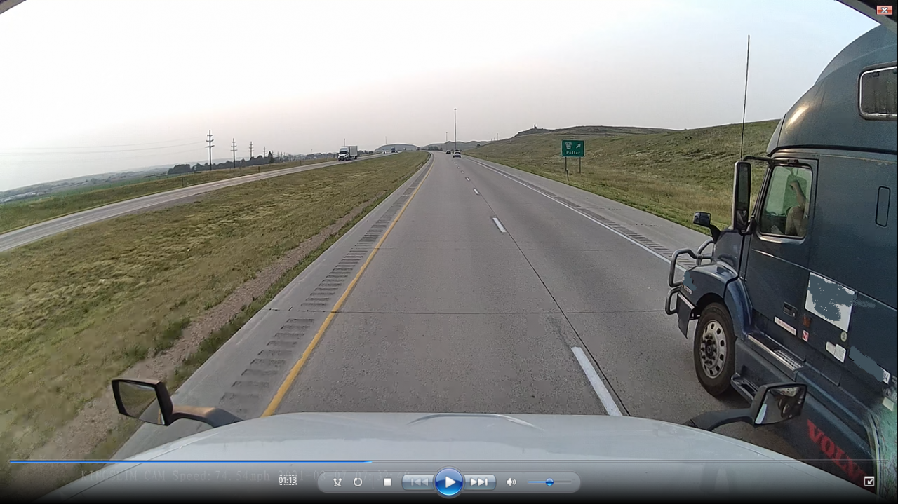

    I have SLIMKING D4. Like it very much. With SD card 256 G full 3 days on high resolution. Two cameras, one forward one rear. Easiest setup interface I ever seen.
    Adjustable shock sensor sensitivity. You can setup to take photo when alarm is on.

    When my car is hit it’s usually in the corner of the bumper. Would that camera pick up something like that? Or even a door being hit against my car? I have several thousands of dollars in damage already. I’m getting a new car and don’t want people to get away with this
  6. Snailexpress
    2,675
    6,069
    Apr 28, 2014
    Rocky
    Shock sensor is very sensitive. If I set sensitivity on HIGH and shake my ### inside the truck cab it will trigger alarm. Wind gusts will trigger as well. Front camera is wide angle to catch bumper corners. Screenshot (11).png
