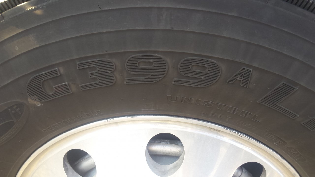

    So anyway, Landstar has great discounts. I'm going to get a set of steers before summer, probably in April. I'm on the fence for Conti's or Goodyear's.

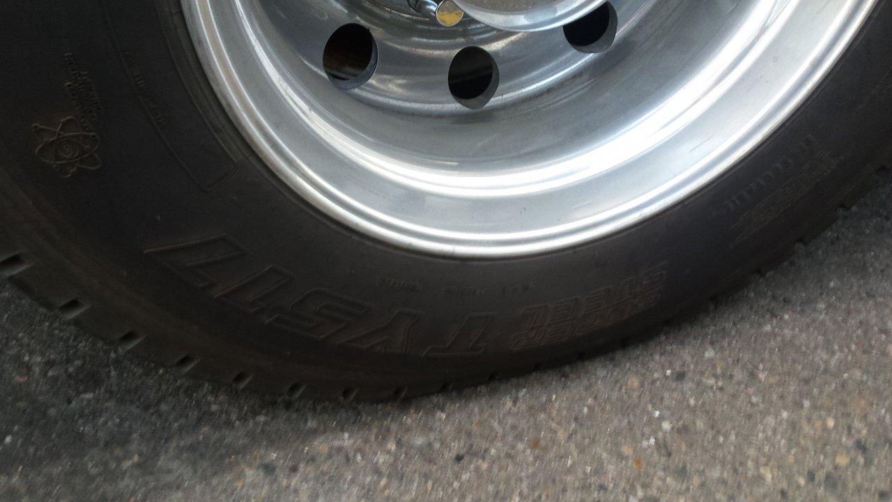

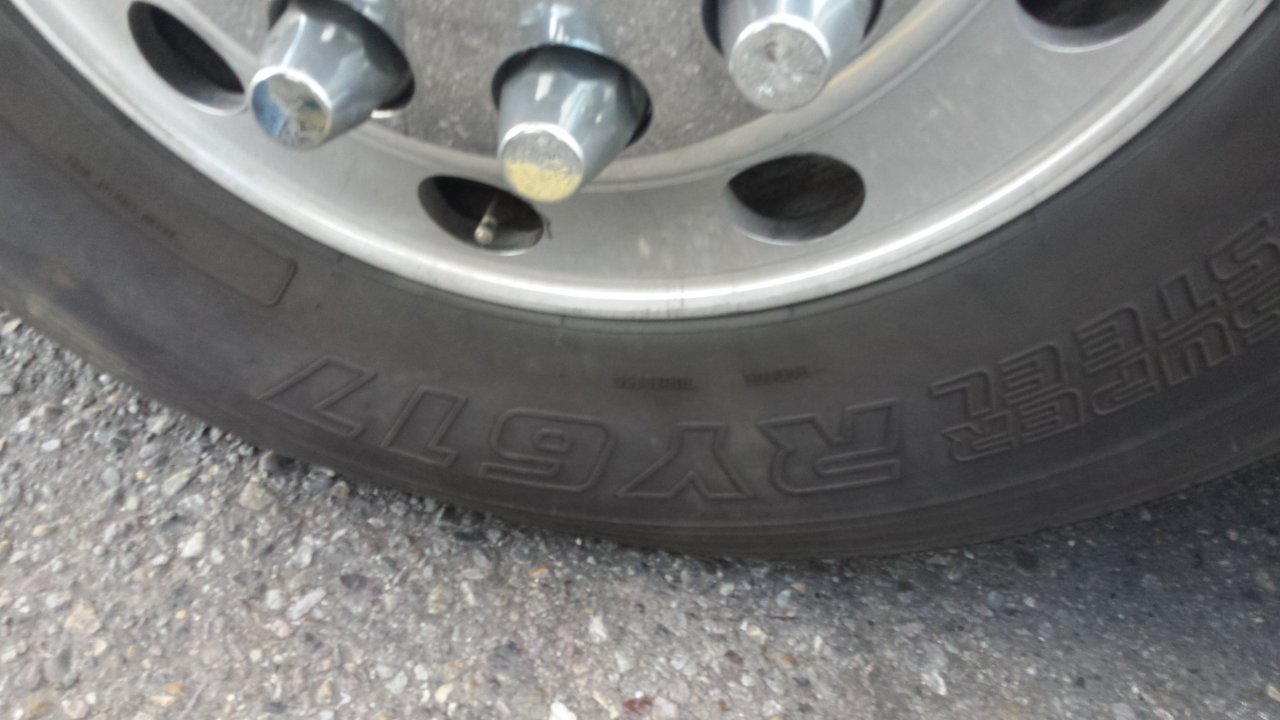

    Yoko's steers went in garbage at 63,000 after alignment & rotation due to driver side wearing WHACKED on 1 rib ( 2nd to outside, then outside cupping ). After rotation almost shook my liver loose between 50 & 60.
    Got Goodyear's & Centramatics. Now have 17,000 on steers ( 110 PSI ). 12/32. Wearing evenly, but seems pretty fast considering they started at 18/32.
