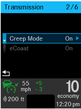

    Click on the Truck picture, scroll down to “ transmission “ press ok. There you will see creep mode and ecoast, turn them on or off.
    They are both on by default so every time you start the truck they are on

    Your ICUC needs to have the parameters enabled!

    @zenaddler
    You need to see a picture like this:
