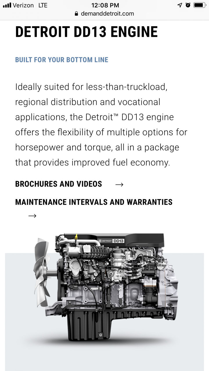

    I found this in Detroit’s website.
    Detroit DD13 Engine | Demand Detroit
    From the pictures you can see the DD13 engine is smaller than the DD15. This explains why some Freightliner Cascadias have smaller hoods.
