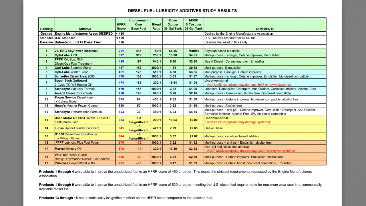

  8. uncleal13

    Hey @mhyn , I wonder if this guys chart has anything t do with pump failures. Shows U.S. Fuel Lubricity standards are worse than European standards. 520 vs 460. Detroit recommends less than 460. We use Co-op fuel, it's rated at <460, plus Stanadyne can bring it down another 160 points. Looks like there are better products if Lubricity is what we're after.
    And certainly a lot of worse ones.

    I am still on stanadyne . I add 4oz every 100 g of fuel. engine runs smooth and less regens I see. what else we can try ? do you consider any other product? say the name and i'll try it.

    Looks like Optilube summer blend has higher Lubricity and lower cost, but I can't buy it anywhere around Saskatchewan.
    Stanadyne I can buy in Saskatoon and yes, my truck seems to like it too. Seems quieter and less regens too.
