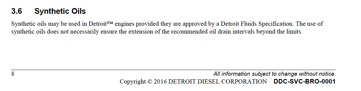

    The only issue is also that 5w30 HDEO is only offered in a full synthetic. 10w30 is offered in both syn blend and conventional varieties. Detroit does not mandated use of synthetic oils in their engines. Allow it, yes. Mandate it, no. Detroit, from the EPA10 DD Engine Users Manual, allows 5w30, 10w30, 5w40, 10w40, and 15w40 in their DD engines. Only requirement is that it meets 93K218 Detroit specs, has a sulfated ash less than 1%, and has a HTHS of 3.7 or higher (40w) or 3.5 or higher (30w). From the 2016 Detroit Lube manual.

    why do you think running 15w40 will make problems later ? all oil change places and truck stops use this oil unless you tell them to do synthetic.

    It won't have any issues from my experience. DD's came out the factory with 15w40 and some of the new ones came out the factory with 10w30. Believe it or not the MCM needs to be reprogrammed if you're using 10w30 in a 15w40 engine. You will have oil psi issues. We had a truck at the Freightliner dealer that kept throwing low oil psi codes and come to find out they were using 10w30 instead of 15w40 and factory said it needs to be programmed to run 10w30 or else you will have low oil psi issues and codes. The truck left with 15w40 oil and a bunch of new parts.

    For the older DD15's you might be correct. My DDEC IV S60, 10w30 worked just fine in it with no ECM changes. But DD15's for the last few years have gotten 10w30 as factory fill so a non issue.
    Not sure about major oil PSI changes that would cause an issue. When hot, under full load, 10w30 was only, maybe, 4 psi less than 15w40 in my S60. That would make sense, since 10w30 is a lower viscosity than 15w40 or 5w40.
