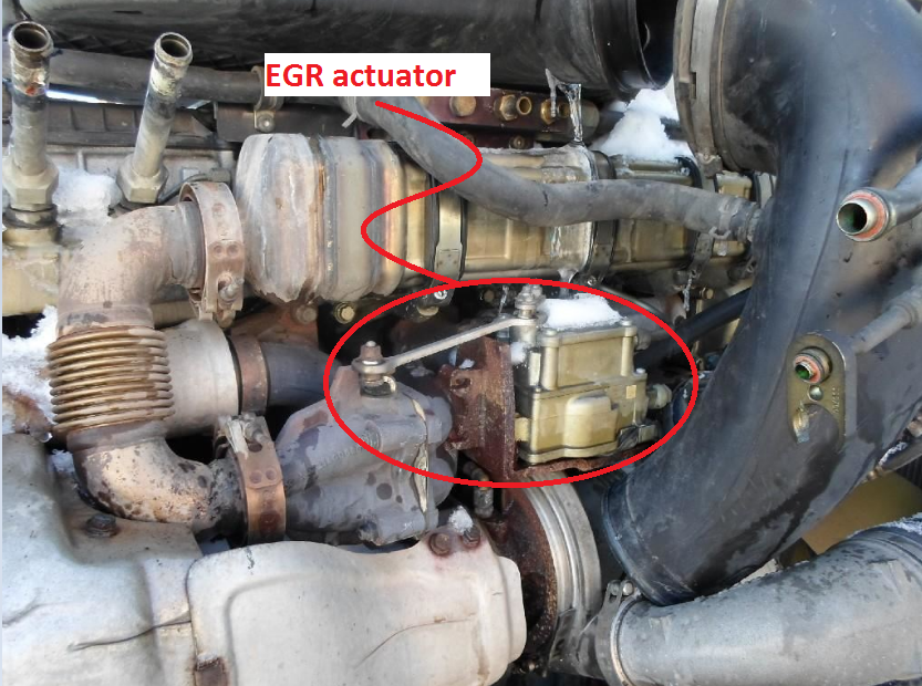

    I know where the EGR actuator is , and i can move the flap easily so its not blocked. What I meant was , how do I spot surge in the coolant ?

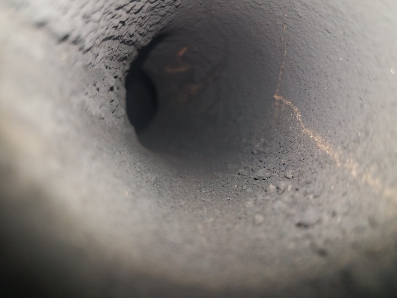

    Only this code plus 3 for spn 411. I took venturi pipe off today and cleaned it and looked thru the pipe that goes into a egr cooler but lookes fine . Here is a pic. im gonna try to hook up to software friday

    Depending on which FMI it is for the SPN 411, it would still suggest a bad delta P sensor/circuit issue.
