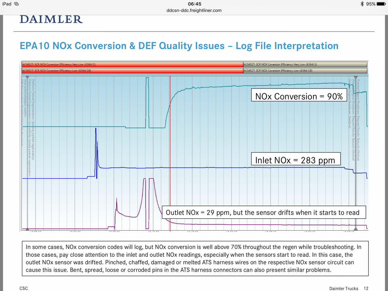

    Hi I'm having some major problems with 2012 Cascadia its been a nightmare truck. It has a low NOx conversion efficiency and bad quality DEF. The NOx outlet sensor have been charged and brand new DEF pump replaced.The dosers cleaned and inspected air supply checked,voltages check all of the wiring inspected. All of the temperatures pressure dosing quantity correct,the whole system removed from the truck and cleaned. Even a DEF tank flushed and refilled. It to the regen starts normally low PPM on the outlet 80% efficiency and then it slowly goes down to 0 and that's it,truck keep regen and it never stops. Any help would be appreciated thanks.

    What do you mean by bad quality DEF?

  8. janboskit
    janboskit Bobtail Member
    12
    3
    Jun 29, 2010
    Chicago
    This is a exact name of code,however the DEF tank been removed and cleaned and DEF fluid replaced.

    This is about the point I would email detroit the log file of the regen and they would most likely tell me it needs a DOC/SCR (1-box).
