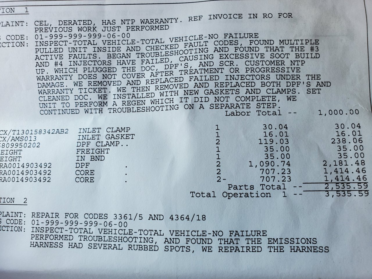

    Hello I had done some work on my 2016 freightliner that I just bought 25 days ago it's used truck with 498.000 miles can you please help me.

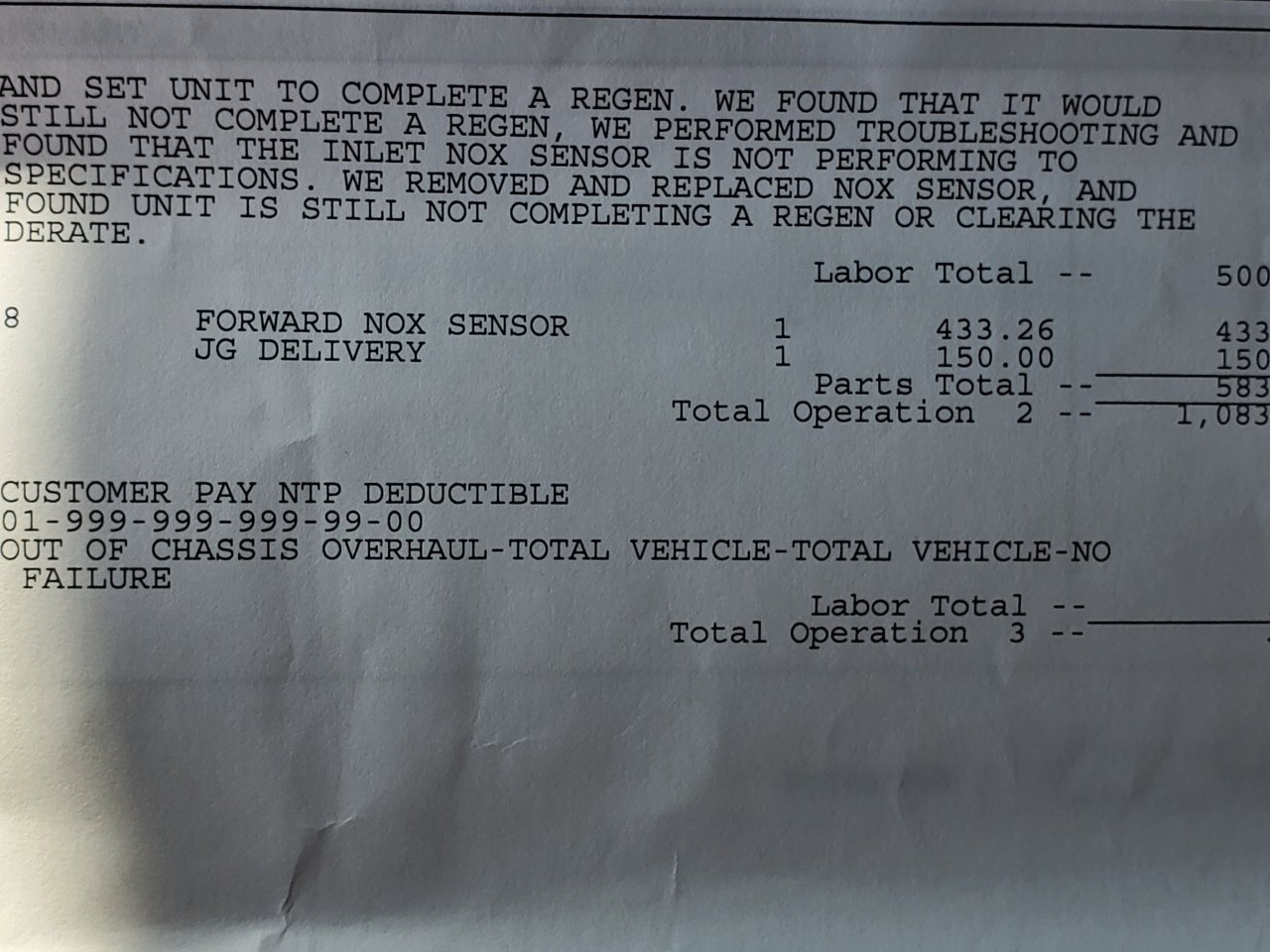

  9. Freighliner DD15
    Freighliner DD15 Bobtail Member
    Joined:
    Apr 3, 2020
    Messages:
    13
    Thanks Received:
    1
    That was done on my truck and after all that repairs still didnt want to do the region all codes comeback again.
    EEC3 SPN 5246 FMI 0.
    They told me I will need new SCR BOX.
    I just bought this truck 16 days ago .
    It's a 2016 freightliner cascadia DD15 with 498.000 miles.

    Prior to that repair I had to replace an sensor on the DPF they installed awning kit as well in the Sprigfield, Arkansas drove 300 miles a d this happened.
