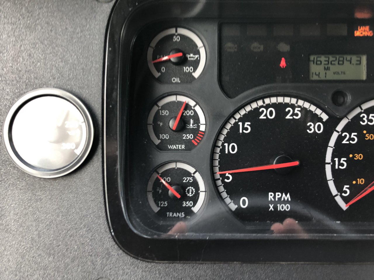

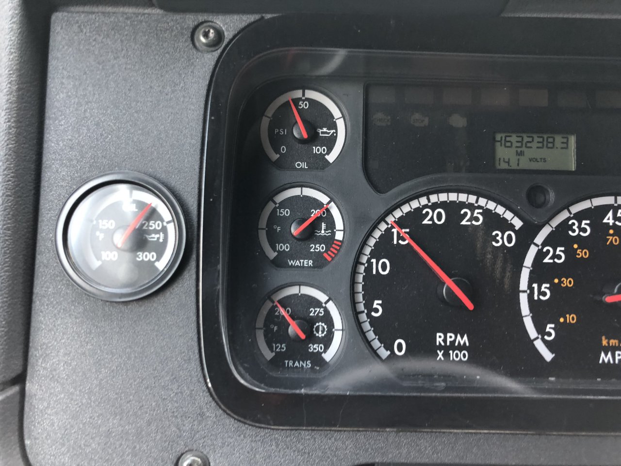

  4. simongrewal
    simongrewal Light Load Member
    52
    37
    Sep 17, 2017
    Indianapolis IN
    3548B2E3-9216-4DE3-9598-C54C0DCA7CA1.jpeg 3812C5BE-792E-4784-86A0-B49645322078.jpeg Hello everyone. I am also having low oil pressure on dd15. It has 460k miles on it. 2014 cascadia Evolution. On idle it shows 10-12 psi and 37-42 psi at 1500 rpm at normal temperature. Usually Oil temperature remain at 225F. There is no engine check light on. Just had service done 3000 miles ago and put 10w30 dello engine oil. Truck is still under extended factory warranty, i am not sure if they cover this low oil pressure issue.
    I tried 15w40 oil earlier but it didn’t show much difference in oil pressure. Usually dd15 has oil pressure of 50psi at 1500 rpm at normal temperature i think. Can anyone suggest what could be the problem for low oil pressure. Thanks in advance

  6. Dmartinezconst.
    Dmartinezconst. Bobtail Member
    3
    4
    Sep 8, 2018
    it's low pressure as in 10 psi being warm oil, whats causing this is the oil pick up tubes have some oil rings they needa be replace with the oil sucker oil ring as well too and for 211 bucks more might as well put the oil pump too.
    New oil, 5 o rings, oil pump, oil filter plus labor 200-300 shouldn't be more then 1000 bucks in labor parts and oil
  7. Dmartinezconst.
    3
    4
    Sep 8, 2018
    It's gonna be the o rings on the oil pick up tubes no more then 1000 in everything that needs to be done
  8. simongrewal
    52
    37
    Sep 17, 2017
    Indianapolis IN
    Thanks a lot for your reply. Should i take it to Freightliner dealership or any other mechanic can do it?
  9. uncleal13
    uncleal13 Road Train Member
    3,797
    6,300
    Apr 9, 2009
    Humboldt, Sk
    Any mechanic knowledgeable on that engine can easily handle it.
    Or if you’re adventurous you could do it yourself.
  10. Dmartinezconst.
    3
    4
    Sep 8, 2018
    He'll no to the dealer ship any good mechanic u know that can be in your town can do it u gotta drain oil pan take it off etc etc etc nothing crazy hard and nothing expensive either
