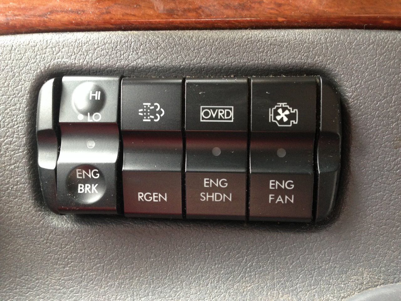

    If your coolant and oil is ok, you can go down the road and when your engine light starts blinking, press the OVERIDE button. I have gone up to 400 miles like that. My shop told me to do it. Check with your shop.

    Were is the override button. I was not aware it had one. Thanks

    It is down there on the right with the rest of them switches. It may say engine override, I can't remember. I have a 2010 that has it. Yeah, the coolant needs to be near the max full line. The minimum full line is a little low, actually.
    Edit: I think it is just right of the Re-Gen switch.

    Here is a picture for reference. Directly below the the air valves, to the right of the 4-ways button on this 2016 Cascadia. If I'm not mistaken, it was in the same place on the 2010 Cascadia I ran.
