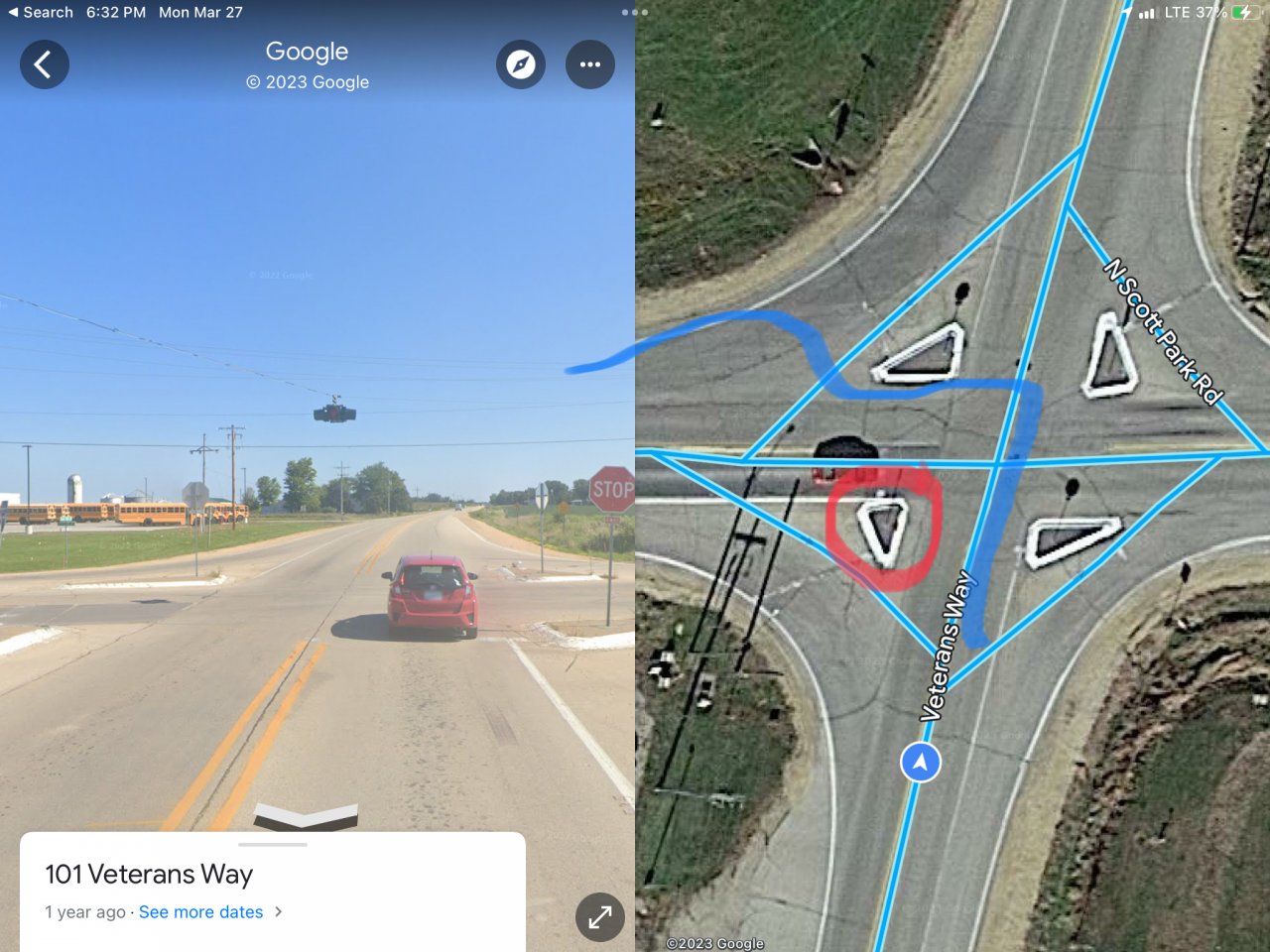

  11. Nahbrown
    Nahbrown Medium Load Member
    451
    2,136
    Sep 6, 2021
    Illinois (the sane part)
    More fun with our Grumpy old Timer instructor today. My wife made it through without hitting the trailer tires on the red circled Median. I was not so successful and clipped it a little bit. The blue line is the path I tried to follow. BC4D3DB2-5113-4EFD-BCF3-8990A6EF9A39.jpeg
    4wayflashers and ducnut Thank this.
