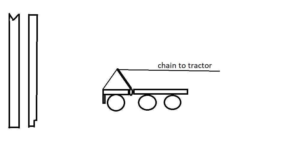

    here is a drawing of how i did it, sorry no picture available.
    i have been medically retired since april /17 and off lowbeds for 6 years (after 35 plus years open deck)

    Similar concept, different style of execution, same results. Nicely done.
