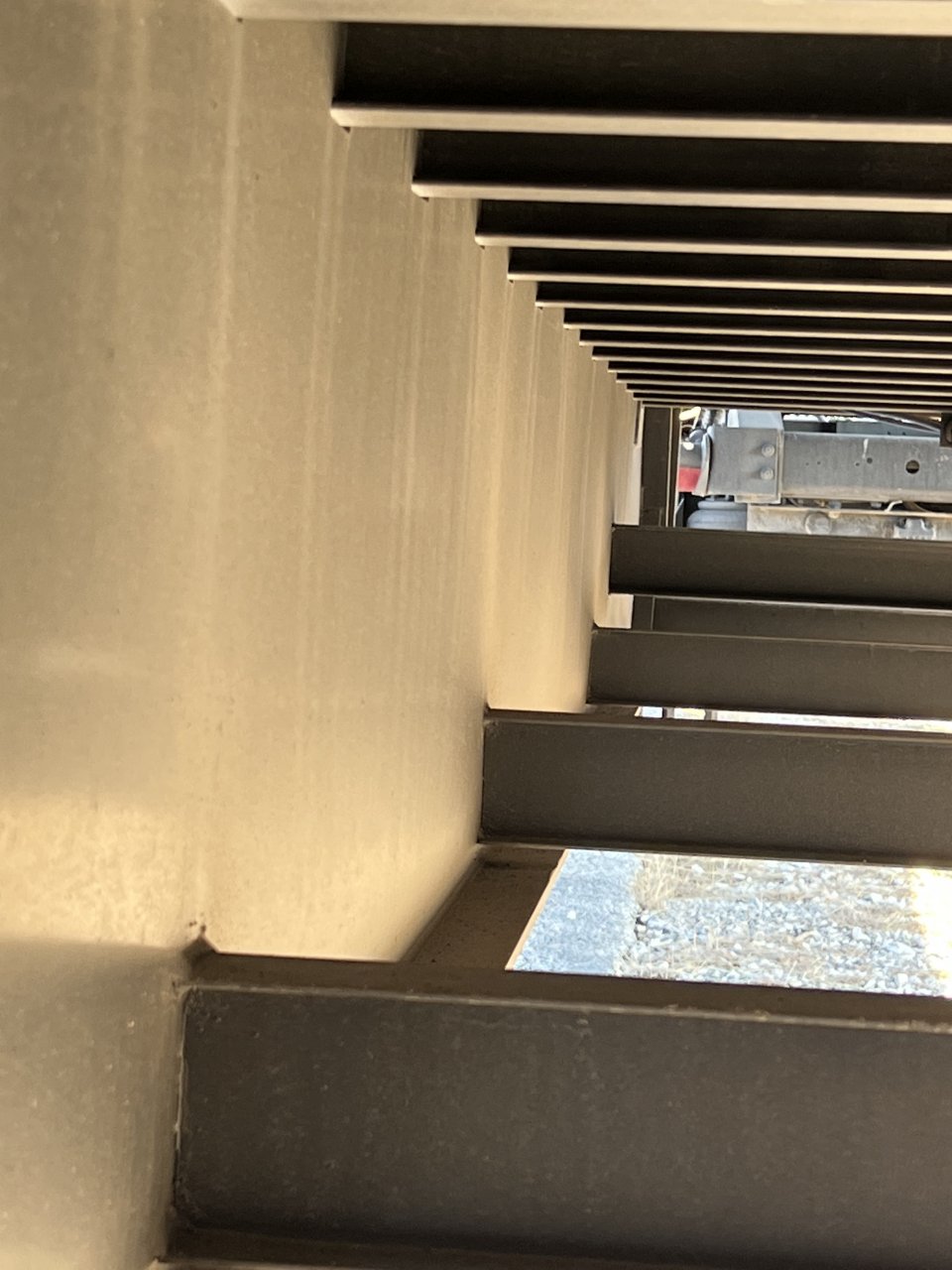

    You might have to actually get dirty and crawl around underneath and inspect the frame and the cross members. Taking pictures of the sides, level ground or not, isn’t the best or fastest way to do this…..

    I agree, get underneath that thing at look everything over. Or take it to a good shop

    And bring a bright flashlight. Shining a light, even in daylight, can show cracks or breaks that you can easily miss without it.

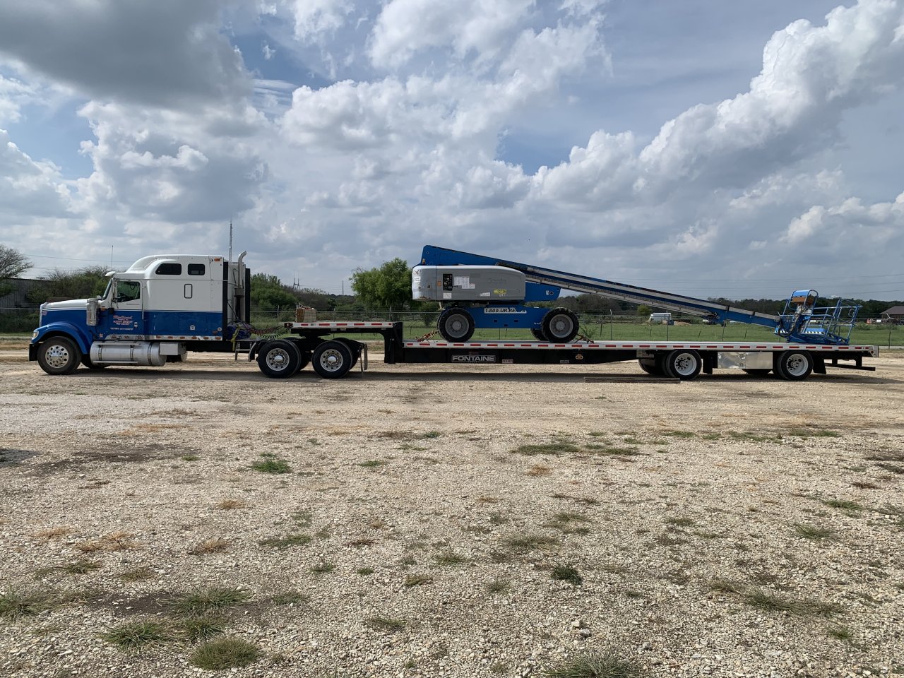

    I’m going to take your advice and buy a couple of 2x6’s.The machine was loaded with the counterweights towards the cap and was about two feet from the step like the picture below but this time the lift was about 10k more.

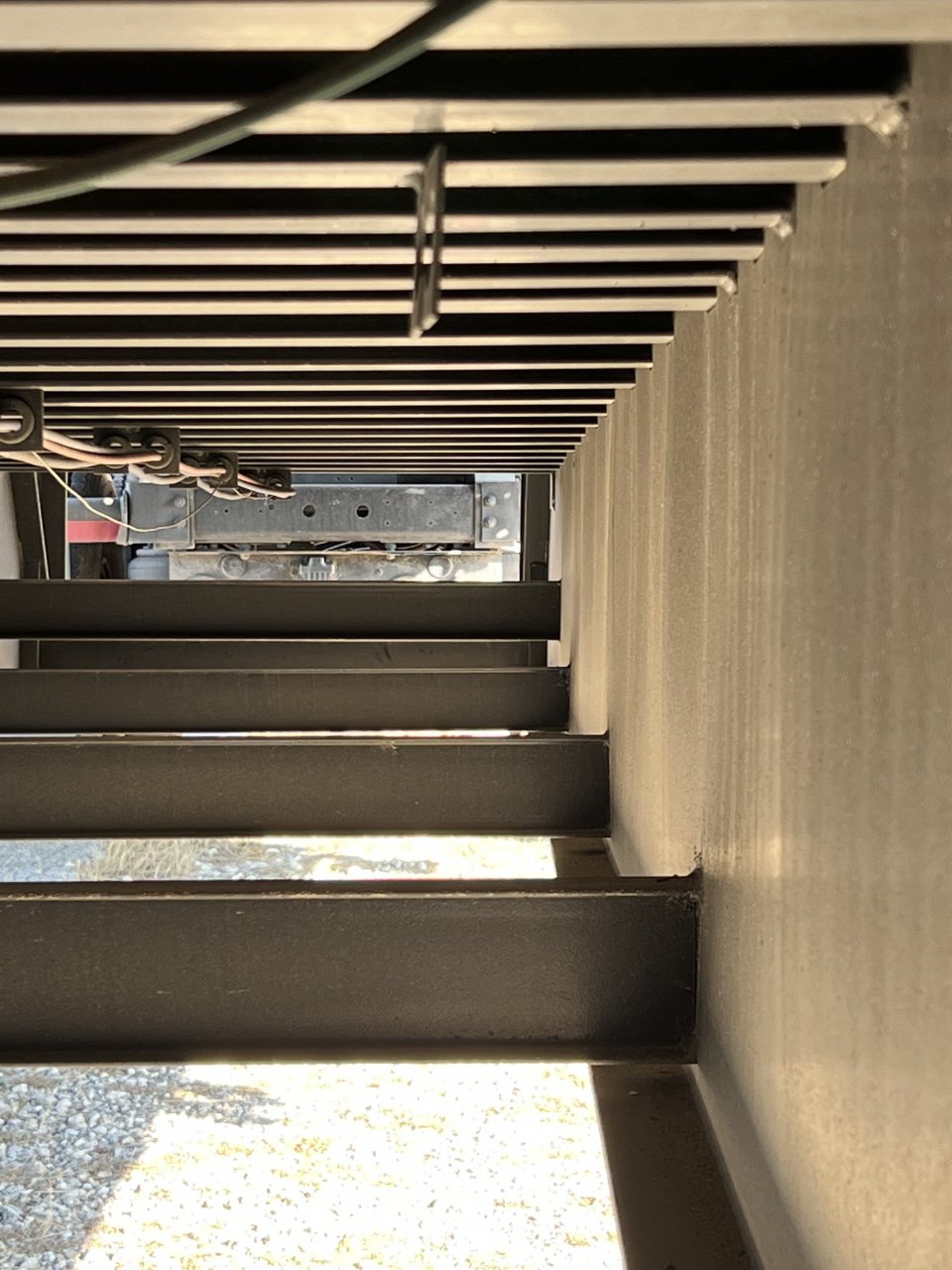

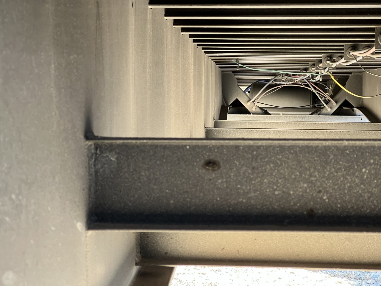

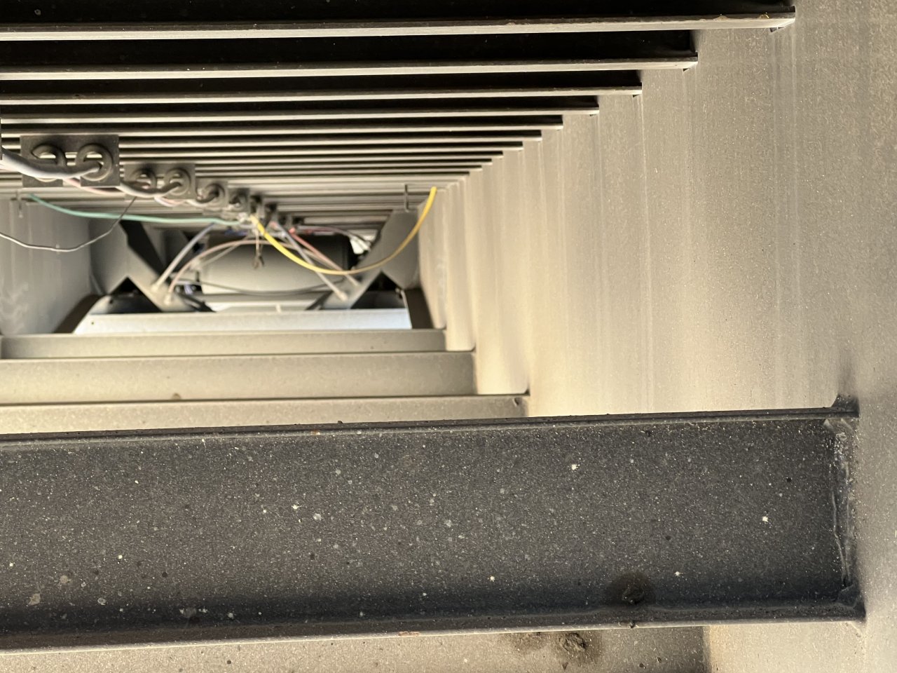

    I did several times on the way home.Crawled underneath it looking for cracks in the steel and in the paint.The main beams on the inside look a bit wavy but not on the outside.I don’t remember what they are supposed to look like on the inside so I don’t know if it’s normal.When I run my hand over the inside beam I can feel them but not on the outside.

    I'd run it. It will probably straighten out in a couple days. I've seen my trailer flex and bend all sorts of ways and come back. Like mentioned earlier, looks like the load was a bit left of center, which took more arch out of that side.
