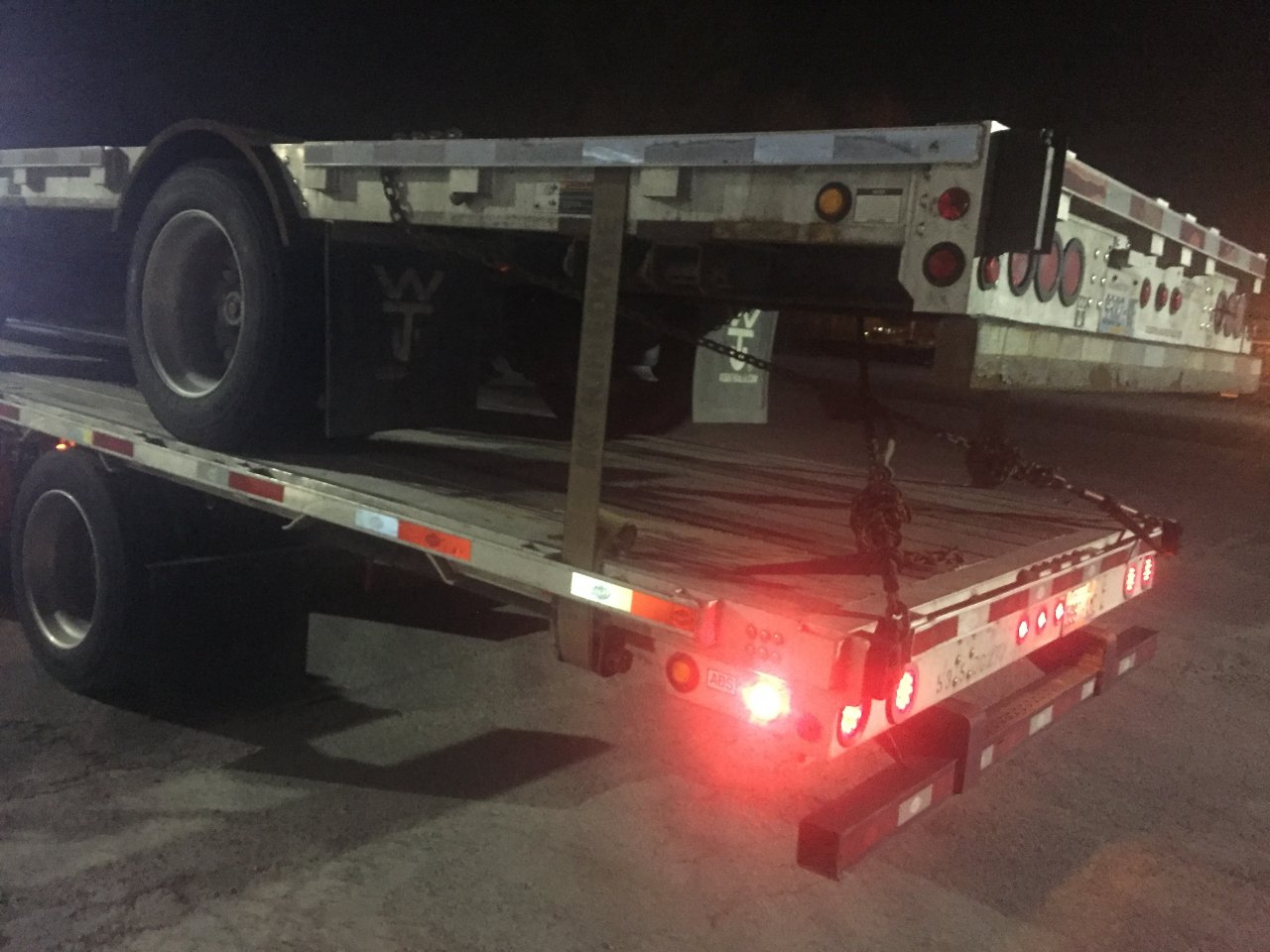

    Here’s how I do stacked trailers. cross chain the ends and a couple of straps to keep them from bouncing. B4F563A8-D2E9-414E-B671-8ED1F8572116.jpeg 6D55D499-15FA-464E-BF63-1CF80F97C2BF.jpeg

    If you load a 48 flat that has boxes on both sides between the spread how are you securing those? You cant X chain underneath like you have picture on that step deck...
  10. TripleSix
    19,085
    133,479
    He has the x chains on the ends, not between the spread. Boxes between the spread shouldn’t be an issue.
