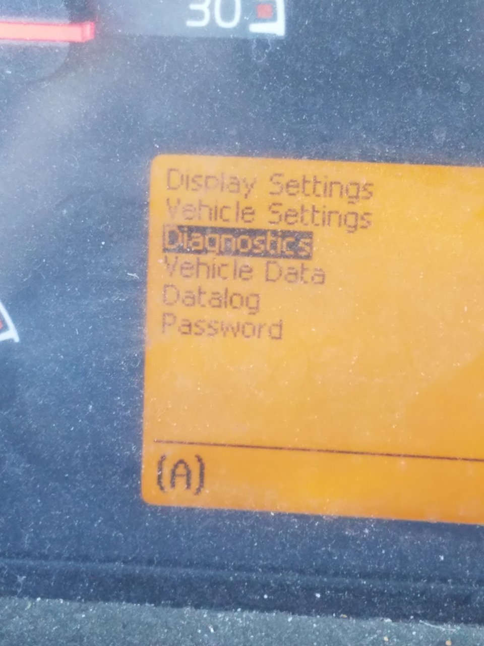

    SOCAL EXPRESS, it's a D13. There was no explanation of the engine fault, I guess I have to find someone who can read it with their computer. I have had def trucks with Swift and Prime, never had this issue. I've driven new and used trucks, this is our first purchase. I'm on my own here and not happy with it doing this right out the gate on our 3rd run from Oregon.

    Use the wiper stalk to get in the diagnostic menu to bring up Active fault codes. If you can get the code then we might be able to figure out the problem.

    It just says, "Engine Fault 1/1", no explanation
